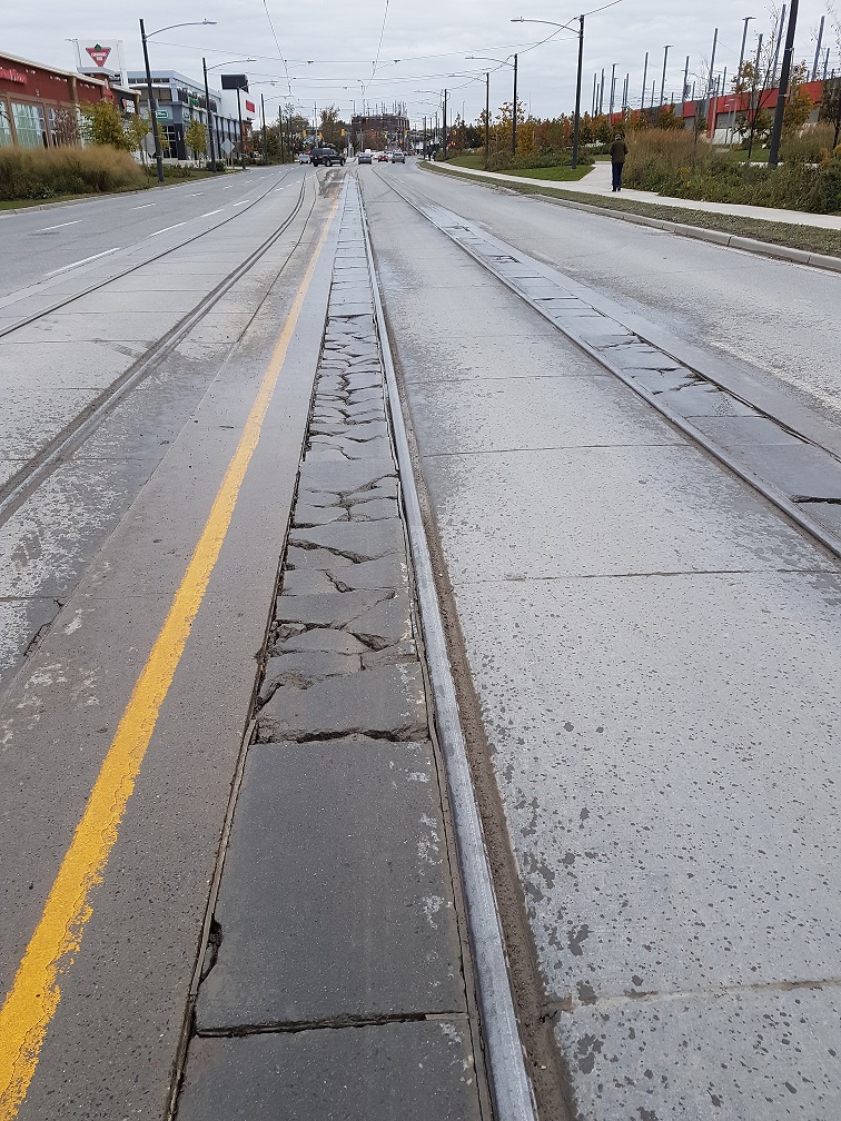

This work is three years old. The concrete on the flanges is so broken it rattles when cars drive on it. From yesterday's visit to the Leslie Barns.

Perhaps not fair. The ground is all fill and a Flexity is a heavy monster. But a very poor result considering both conditions were well known.
Yes, the size/weight of the Flexities was well known by time track was laid - it's either poor design or poor workmanship. The TTC seems to have lots of problems with this concrete 'flange' all over - several poor stretches on King (eg @ Frederick).
I could be wrong, but I believe the connection track on Leslie was built by the Leslie Barns construction contractors (Pomerleau?), and not the the typical TTC crews/contractors. The track base design is also unique due to the soft earth conditions underneath, with a reinforced concrete base, and lots of isolation for vibrations. I'm no expert, but looks like there's almost too much isolation on the concrete strip outside of the rails, so it is less secure, and thus the crumbling. Hopefully it'll just be an easy fix, and maybe still under warranty.

If it is a result of contractor error, how can they screw up concrete this badly? It makes me wonder if the trackbed at Leslie Barnes will be just as bad or nearly just as bad in a few years.
