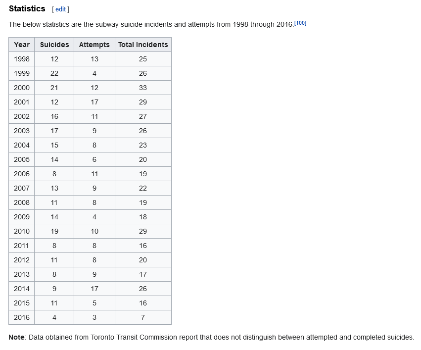

On the subject of Platform Edge Doors; While I agree that the media coverage at times can be overly-simplistic, I disagree on the value of the idea.
If you view the value as one of saving the proverbial innocent victim of a criminal shove, then yes, as tragic as such things are, they are also exceedingly rare, and the investment would be hard to justify.......
But when you extend it to suicides, the numbers are much more substantial.
Source: https://en.wikipedia.org/wiki/Toronto_Transit_Commission_incidents#2020–2029
The average appears to be in the low 20s with up to 33 attempts made in any given year.
That's not 'If it saves one life'.........
Granted, if that method of suicide is eliminated, many will find another, though some net reduction is likely.
But if one were remarkably cold, (not cruel); and set aside the impact of the suicide attempts on the persons involved, witnesses and operators.....
You're talking about ~25 service interruptions of 2+ hours every second week; that's a lot of inconvenience, and hassle and late-fees for parents picking up children from daycares, and people late for work or school or doctor's appts etc.
