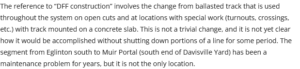

Also of of note is a move to replace all ballasted track with concrete slab base.
Not all track, just the track at interlockings - switches, crossovers, etc.

Steve Munro's post shows all 'open cut' sections on the list: (last item, centre section)
Is this not correct?
I read "Rehabilitation of open cut ballasted track" to mean just that - rehabilitation. New ties, new ballast, whatever is needed. I don't see that as retrofitting it to Direct Fixation, especially since they used very different language - and in fact, those exact terms - in the point immediately above it.
