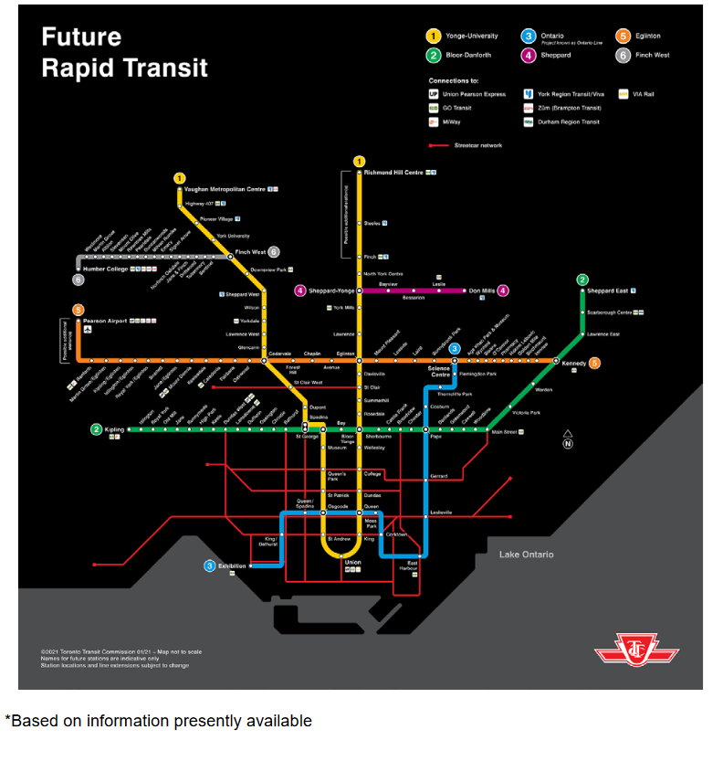

We’re maybe going to get the BD extension to Sheppard and the Ontario Line. But everything else seems like wishful thinking given our Province’s history.
I was about to say the same. 2031 is a bit optimistic. 2035 is a more realistic date for all these to be in service.
