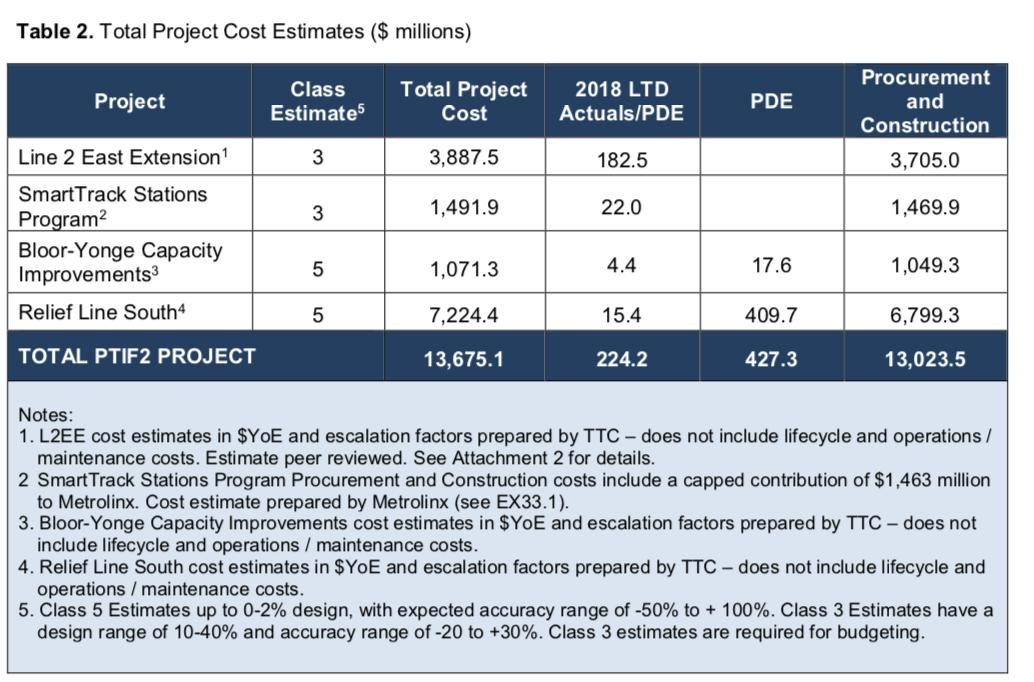

Jimmy K and friends will not like the absence of a Sheppard East subway extension, and no Sheppard West extension for Jimmy P. Tears before bedtime in the North.
