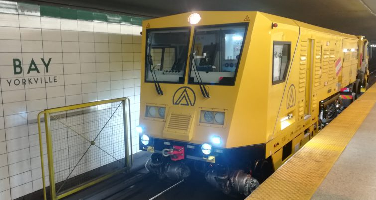

TTC New toy
175076
Rail milling comes to North America
The TTC, which has used contract grinding services for the past 10 years, elected to incorporate milling into its rail maintenance programs after observing spark- and smoke-free milling operations in Europe.
Maybe they could learn a lot more if they came into the modern age? Unbelievable that this hasn't been done before.

TTC is supposed to be the first system in NA with this toy and how do you class other systems that not only don't have them in NA and are older than TTC???
Interesting. Wondering if there's an opposite to rail grinding. So rather than "smoothing out" any variation by grinding a large area flush with the depth of the pitted track, which in a way is fighting fire with fire, some kind of composite or epoxy is laid into the worn out area of track. Effectively filling in the gap and literally smoothing it out. Just a thought, though unlikely such a material exists that could adhere and withstand the weight.
You can weld on more steel, but has to be the right grade, oriented and cooled correctly, then ground or milled to form, It could serve in an emergency, but won't last. There's no way to replicate hot rolled steel rail:
It isn't done on tangent track as the heating and cooling cycles will destroy a lot of the properties that the rails need, but yes, additive welding is done all the time to the tips of frogs at switches and crossings.
