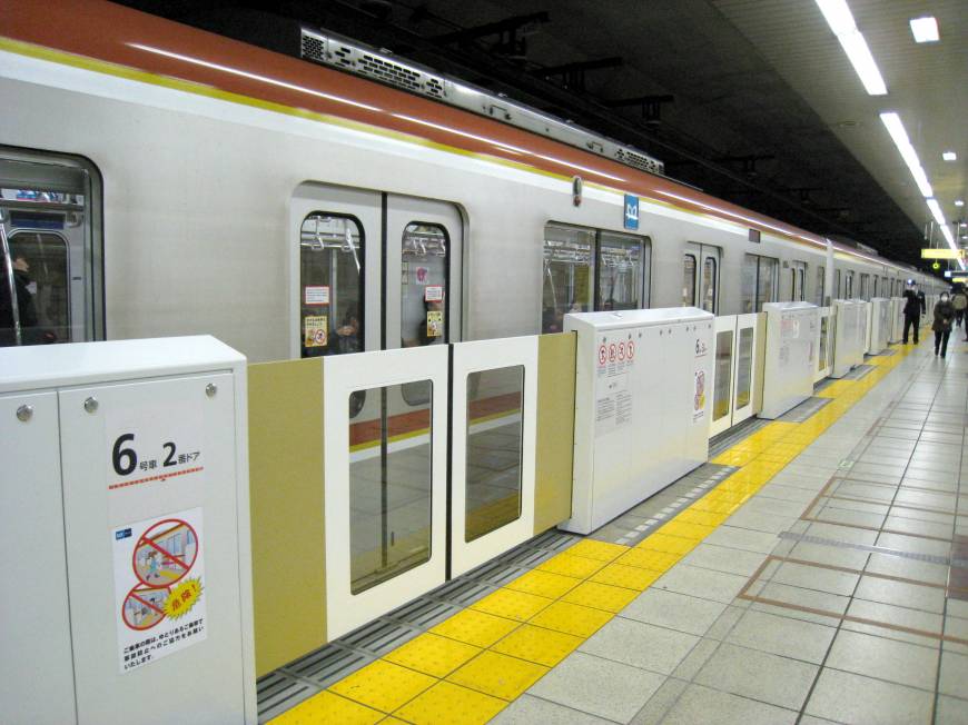

If the TTC and Toronto were serious about Platform doors and actually could afford it why not go with half-height doors? For the older sections of the system (line 1 and 2) which were built with smaller stations and lower ceilings half-heights would be a much better option as the impede access to track level while still permitting airflow through the platform level. As well while it may seem like a small thing there is a definite "aesthetic" to the use of platform doors. Small stations with low ceilings (like the majority of the Subway here) would feel far more claustrophobic and just more oppressive (does anyone remember the picture of Rosedale with full-height doors). There is a trend when looking around the world for platform doors and the design of the stations they tend to appear in.
To me converting a pre-exisitng line to full height is just not worth it since the stations were never designed for such a thing. Things such as air ventilation systems would need to be installed and I am sure this is where the bulk of the $1 Billion cost comes from. For a pre-existing line half-heights are the options while for a completely brand new line (the DRL) you can use full-heights because the stations would be designed with them in mind.
The doors themselves could be porous or if plexiglass, be perforated with holes. They could even be stiff mesh.
Actually a lot of track fires are caused by garbage ending up on the third rail. PSDs will reduce a lot of those problems. TTC should stop talking about PSDs as sometime to prevent suicides as people will argue that they should spend the money in mental health instead but as a way to reduce delays and increase reliability.
Actually, air ventilation is an extra and some form would be required for half-height doors too. Older sections were built with the assumption that station stairwells would help vent smoke. While already a poor mechanism, even a small obstruction causes issues with that concept.
