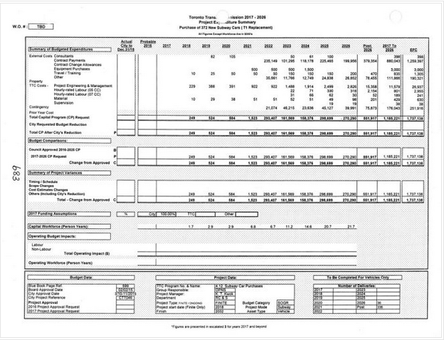

From the 2017 Capital Budget, the Line 2 fleet plan:
This plan does not align with construction plans in various ways:
  • The SSE extension service is shown as operating effective in 2023, a date long-known to be unachievable. The opening is now tentatively aimed at 2026.
  • Procurement of replacement cars is shown as starting in 2026 and running through 2030. This aligns with a roughly 30-year lifespan for the T1 fleet.
  • Plans for ATC on Line 2 now show this project completing in 2024, and the SSE would be built as an ATC-only facility. Therefore, a new fleet must be completely in place before the SSE can open.
  • The total number of trains the TTC would have by 2031 is less than what they claim to need (69 vs 71).
Accelerating the provision of a new fleet would be challenging on the basis of a completely new tender and design, whereas resuming production of the TR trains would avoid the need for prototyping. However, this would only be possible with a sole source contract to Bombardier who are not the TTC’s favourite supplier at the moment. Moreover, the entire project would shift forward and add pressure to spending during a period when the City does not wish to incur any new debt to finance capital projects.
There is no funding in the City’s Capital Budget for these trains. The seven trains shown in the fleet plan for “SSE procurement” are not included in the SSE budget.
