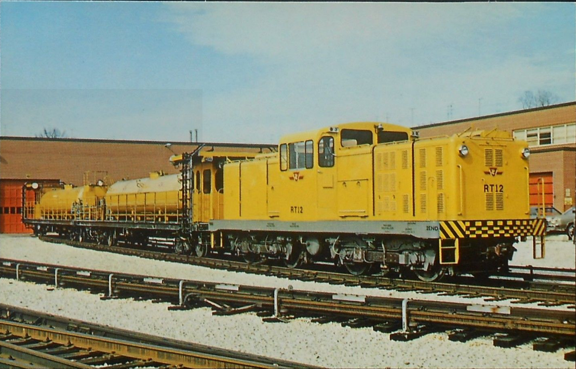

Where are these now?
Say hello to the ttc firetrain : toronto
Reddit
3165 × 2144Search by image
This is the tunnel washer: ...
So is this thing still around or did some short-sighted git have it sold off or scrapped?
It's a damn good question, and there have been many over the years...at the time the tunnels were a *lot* cleaner than they are now. Does anyone else remember when the tunnels were cleaner? It's not just the tunnels that are black now, it's the stations too. And not just a shadow, but solid black grime.
