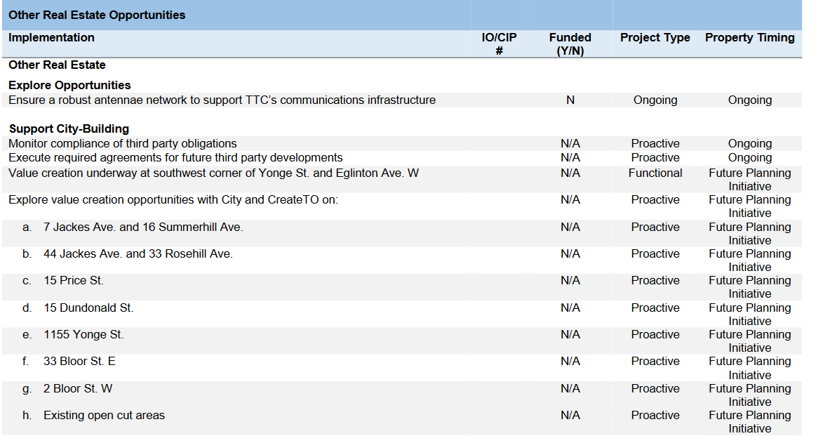

So, I'm putting the links to the TTC's 15 year capital investment plan here:
Yes, that means next week's meeting agenda is up, inclusive of the budget.
I'll just put this one item of interest for now:
But go digging UT, there's some interesting stuff hidden there.
