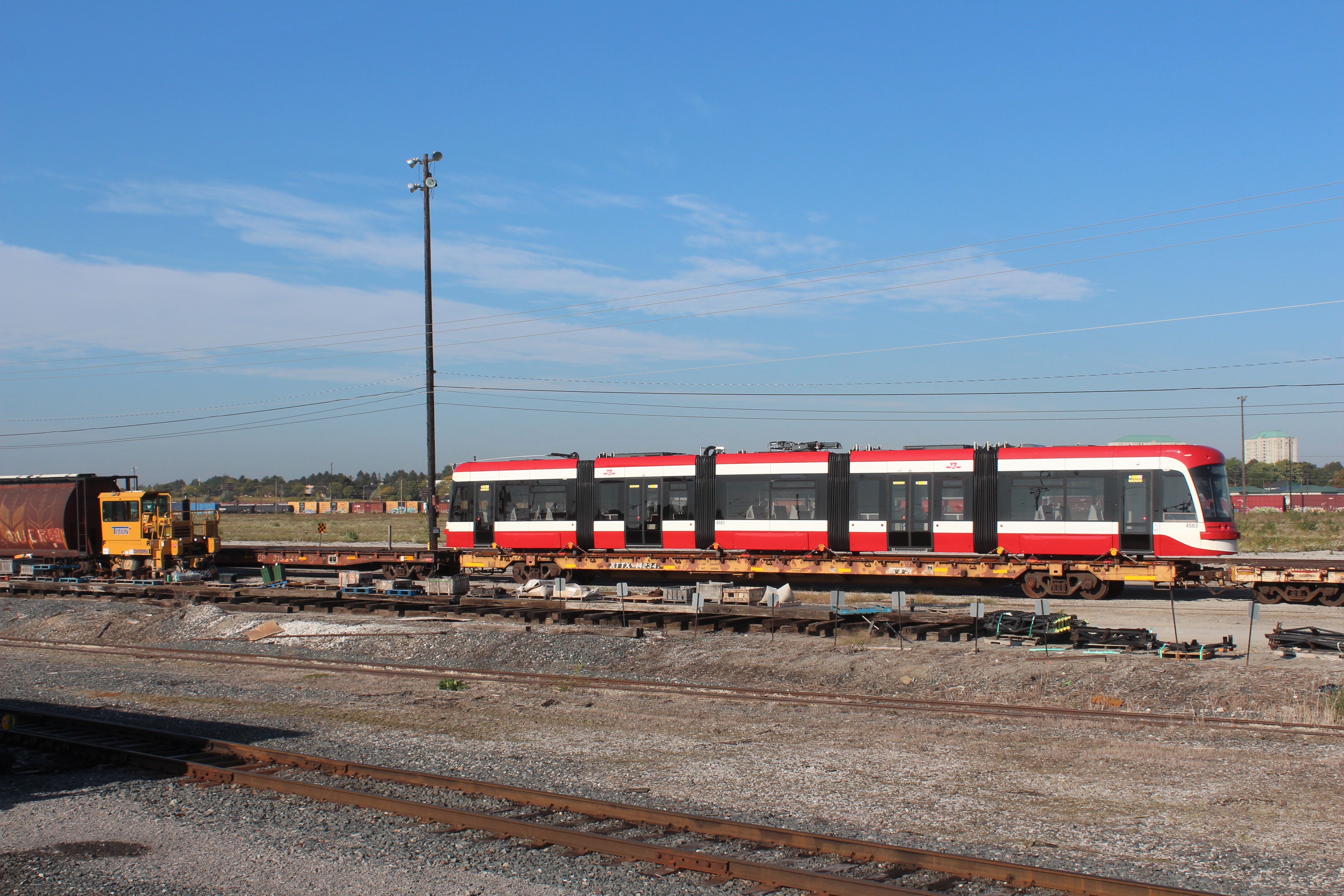

4577 was off loaded today with 4400 and 4583 waiting delivery to Hillcrest.
re 4583
re 4583
What will be off loaded next; 4400 or 4583??? Maybe 4584?

4400 was off Thursday and is tracking. It left for QC Sept 07, 2018. That make 392 days since 4400 was loaded for QC and 400 days since seeing service.
May see 4583 Friday.
4582 out testing.
