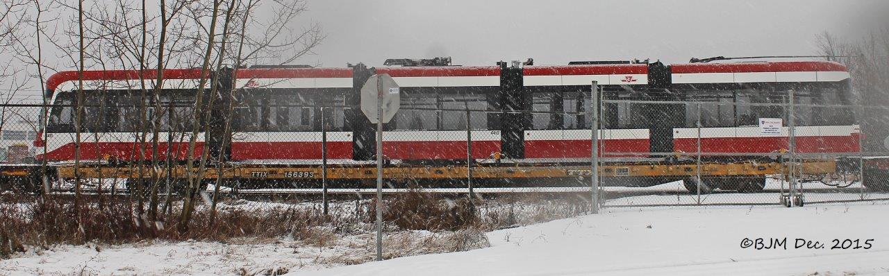

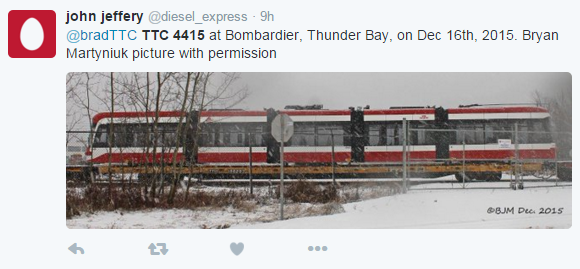

Pics or it didnt happen
You said the same thing several times before. Once again, here's a picture if you don't believe us:
CWZ25KvWwAE9heb.jpg:large
Depending on a few things, we could see 4414 & 4415 on the road by year end. 4415 is on its way down now and 4414 could hit the streets by Dec 24.
