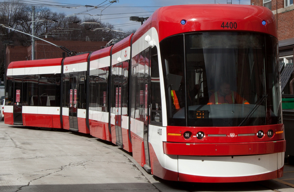

Well, the world didn't come to an end when the ALRV's and CLRV's were deployed 30+ years ago without a cow catcher, so I imagine these new ones would have the same impact.
ALRVs had the lifeguard cradle under the front when they were new, it may have been removed since then. Esther Shiner decided that pedestrians needed to be protected from "being mangled" by the CLRV couplers so the skirts were installed in 1986. I don't know if there were any pedestrian injuries caused by being hit by the couplers, but it was apparently enough of a concern for a councillor to take it up as a cause.
The skirts were created and installed because of the potential for passenger injuries, but the ALRVs have never had a lifeguard/cradle installed. The ALRVs were never designed for MU operation, so there is no way to install a coupler.
The world did, in fact, come to an end for many unfortunate individuals who made contact with the front end of the "new" streetcars. The "skirts" were an attempt to deflect victims away from the vehicle. Unfortunately, it was found that if a victim was shoved forward onto the tracks by the initial impact, instead of off to one side, they were still dragged under the skirts during the secondary impact while they lay on the tracks. Toronto Fire brainstormed the idea with the TTC during the 1980s, eventually developing a complex lifting procedure using air bags and 6x6 blocks that has saved many lives. (Tragically, one firefighter was killed after an early prototype of the lifting equipment failed at Hillcrest in the late-80s). These procedures are now being refined for the LFLRV cars.

They sure did. I was a summer student in the carhouse when the ALRVs were new, and they were definitely equipped with the lifeguard trip bar and the cradle. When the cradle dropped, there was a button on the dash with a pneumatic control to raise it, unlike the PCC cradle, which had a cable reset under the operator's dash. I think the cradles become troublesome and were removed at some point, but before that, one CLRV was even experimentally outfitted with the lifeguard bar and cradle in the mid-1990s (car 4073 I think). I have a copy of the Russell Division newsletter with the CLRV info.
Used to be very massive, on the early streetcars. Today, they are likely nonexistent. Guess they just gave up.

I'm guessing they're hoping the round front shape would deflect any "obstacle" to the sides. Hope the cow will come out okay.
WKL and Everyone: Noting that the new ALRVs are not designed for MU operation can they operate with longer sections?
Example: Instead of 5 sections increase them to 7 sections for use on busy routes especially grade or street separated types...
