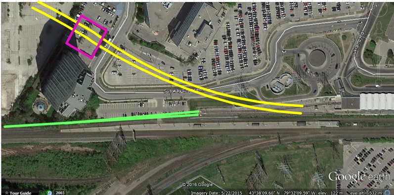

How are you going to do grade when the rail corridor is off the table and a nice condo west of Kipling in the way?
I think what you are saying is that it is nearly impossible to go under the condo if you try to bring the line up to Dundas (yellow). Unless you demolish part of the structure, with parking above it (purple).
Going at grade just south of the condo is the much easier route (green). It is a bit tight, and the tracks would have to be stacked. There is 250m beyond the station so one track would ascend and the other descend (say at 1.25%), and that provides the 6m difference in track elevation to do it. It would sort of be a +/-150m long open sided box culvert (the side facing the condo is closed, and the side facing south is partly open to avoid complexities of tunnel related safety requirements) running east-west, with retaining walls running (to separate the near parallel tracks with differing elevations) another +/-200m on either side. This is simple culvert type construction that any local contractor can do, and not tunneling - which requires specialists from outside. Couple of $10M dollars of extra structural work on top of simple at-grade construction still makes this the most economical solution by far.
That building north of the condo would become history since it has not effect on the condo parking in the first place. The condo parking is at the south side beside the RR Corridor. Its a lot easier to build something better at the corner than what there.
As I have stated, the rail corridor is off the table for the subway. All the land west of the condo is slated for redevelopment 100% including up to the rail corridor. The residents of the condo will opposed any surface subway next to them.
Have you listen to all the complaint there has been over the years regarding the surface line from Islington To Kipling??? The switches have been the main issues.
