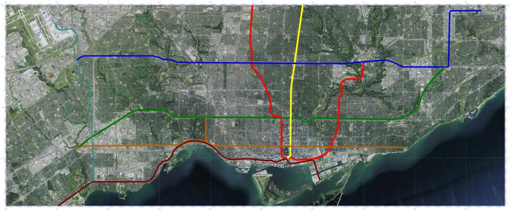

To further what CC posted, I did up a quick map of how a Queensway LRT could theoretically be implemented as part of a 'South of Bloor' transit plan. A bit fantasy in nature, but a good exercise none the less.
