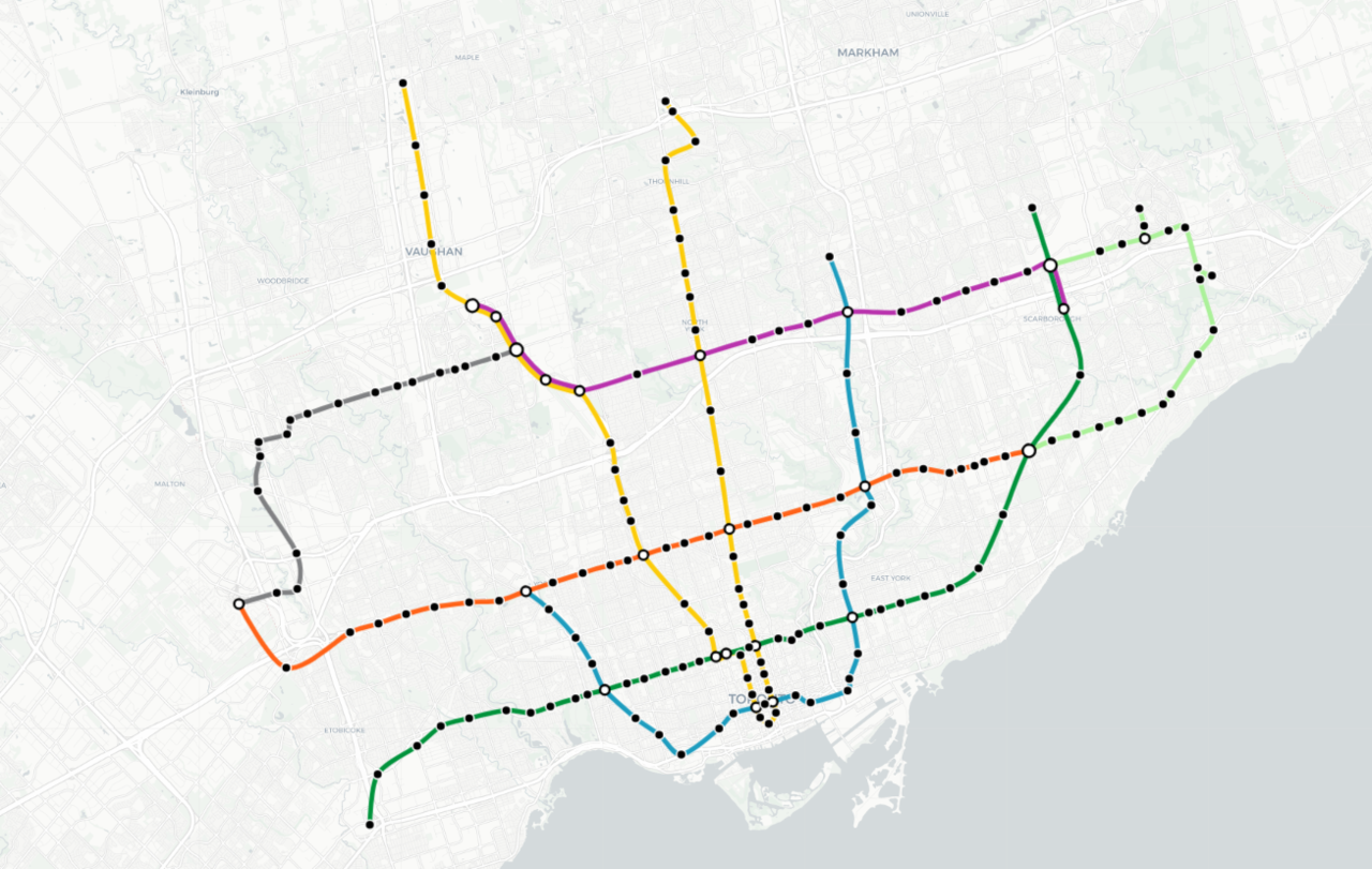

here is my subway/lrt fantasy map for the 2040s first and then the 2050s
Line 1 Yonge University : Major mack west - union- RHC
Line 2 Bloor Danforth: Sherway - Mccowan Finch
Line 3 Ontario: Mount dennis - Exhibition- Seneca
Line 4 Sheppard: Pioneer Village- Sheppard Mccowan- STC
Line 5 Eglinton: Pearson-Kennedy
Line 6 Finch West: Pearson-Humber-Finch West
Line 7A Eglinton East: MTC-UofT-Kennedy
Line 7B Eglinton East: Sheppard Mccowan-UofT-Kennedy
line 1 Yonge University Jane :Major Mack West-Union-Major Mack
Line 2 Bloor Danforth Mccowan : Square one-Markville
Line 3 Ontario: VMC-Exhibition-Markville
Line 4 Sheppard: Pioneer village-STC
Line 5A Eglinton: Pearson-Kennedy
Line 5B Eglinton: Square one-Kennedy
Line 6 Finch: Pearson-Humber-Mccowan Finch
Line 7A Scarborough East: Mccowan Finch-MTC-UofT-Kennedy
Line 7B Scarborough East: Mccowan Sheppard-UofT-Kennedy
Please share your thoughts and suggestions.

really like the closing of all the loops and the introduction of interlining where it makes a lot of sense. Obviously you kept it realistic with existing/planned transit projects, but by 2050 I really think the need for an additional downtown subway will become clear. Whether or not it is an east/west line or north/south depends a lot on if the streetcars are improved, but i would have to guess a Dufferin subway from Yorkdale to Exhibition would be in the works if not built.
I really can’t say I love an iteration that doesn’t involve getting to Unionville station…. I’d be more inclined to serve the airport lands by pulling the new version of VIVA Green east to Woodbine by way of Seneca College.
that is a good point about Viva Green. I guess it really depends on how the density around buttonville will look as it is pure speculation, but downtown markham willl certainly show itself deserving of a station by 2050.

I agree with most of routes. Just a few nitpicks:
1. It will be difficult to interline in all cases where you have multiple colors running together. Say, Sheppard West towards York U and VMC: the yellow line tunnel is already built, it will be a challenge to connect Sheppard line tracks.
I'd rather send Sheppard line further west, possibly swinging to Wilson, and thus add transit coverage to the otherwise underserved north-west. Then the Sheppard line could go to the airport, Malton, or all the way into Brampton. Or it could just terminate at the Woodbine GO station, connecting to the Brampton / Georgetown RER that should become fairly frequent by that time.
2. Interlining OL West with the yellow line would be even harder, as they use different technologies and perhaps even different gauge. Jane is one of the good route choices for the blue line, but I would either terminate it at Steeles West and go no further, or swing further west after Finch and serve Woodbridge.
3. In the east, a bit more chances to see the magenta and green lines interlined, but that's not trivial as well. Design for SSE is completed, the McCowan terminus will have the tracks pointing straight north. The only way for the Sheppard line to connect is to veer north before McCowan, and then curve south to align with the SSE tracks. Not impossible, but unlikely. We probably have to choose one connection for the Sheppard line: either McCowan or STC, but not both.
4. I don't see the green line going into Markham. The blue line, yes, it will take many riders where they want to go, and be popular. But the green line - too far east for much of the existing density, doesn't go straight into Toronto downtown, and has too many stops because of the close stop spacing east of Vic Park. I would terminate the green line at Sheppard, or at most Finch, while McCowan North will do fine with BRT.
5. In the Phase 1 map, 7A and 7B (light-green line) both go to Kennedy, and that's fine, but I believe the most popular branch will be 7C that connects Malvern to the subway terminus at Sheppard & McCowan. For someone boarding at Malvern Centre, good 20 min will be saved by choosing the shortest trip to the subway, rather than taking a sightseen tour via much of Scarborough to transfer at Kennedy.
