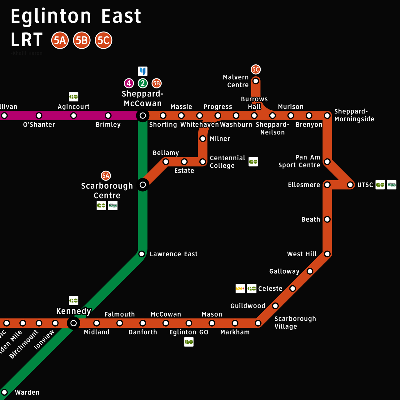

Whipped this up pretty quickly so there's prob mistakes and its def messy buttt... Here's my concept of a branching, interlined Eglinton East LRT.

The majority of the line follows it's currently planned alignment, but at Neilson, one out of every three trains turns north to Malvern, but with decent frequencies, this shouldn't be much of a problem. The other trains continue along with Sheppard in their own ROW until they split in two again at Progress. The trains that head south travel along progress in dedicated lanes with a stop at Centennial college's Progress campus. They continue along Progress for a short bit until turning onto the ROW reserved for the SRT extension that never came, shortly before making its way onto the eastern leg of the SRT's corridor itself, terminating in the retrofitted McCowan RT Station at the new Scarborough Centre Station. The trains that continued along Sheppard head to Sheppard-McCowan Station to meet with lines 2 and 4

This would probably operate best as a separate service from the crosstown but for aesthetic's sake, I just made it an extension. I took the liberty of naming some stations on the EELRT and Sheppard East Subway Extension myself... which proved difficult with three different Markham Stations. There are two more branches I wanted to include but 5 branches on one line are a bit obscured and the frequencies at the ends of those branches would just be too abysmal. I wanted a branch running along Kingston and in the middle of highway 2a to port union road, and another headed for the zoo along Sheppard or the hydro corridor, and Meadowvale. My mind is currently trying to figure out how these could work and the best I've got is an lrt along Lawrence and Kingston from Lawrence East that branches up to Meadowvale from old Kingston (it'd have to be in mixed traffic), to Sheppard from highway 2a, and rouge hill go along Lawrence. There is definitely not the demand for this at all unlike the EELRT but one day. It could also use the EELRT since the interchange at Morningside. I also think it's pretty sick that this would give every centennial college campus or learning site a rail connection, most of which all being connected to line 5

Very cool map! Two notes:
1) Why not add a direct LRT connection between Malvern Centre and the McCowan&Sheppard subway terminus? All the tracks already exist in your map. And that direct connection will be the most popular LRT route in the north-east.
The "5C" route on your map may be useful for some riders who travel within Scarborough, but noone will ride it end to end. A short trip to McCowan&Sheppard and then a subway ride will be a lot faster, if you are heading to Kennedy Stn or past Kennedy.
2) If you want to serve Centennial College Progress campus with LRT, that's great but I would consider a more direct route that stays south of the 401. The "5B" and "5C" routes remain as is, running via Sheppard. But instead of "5A", there would be a separate route that starts at STC, serves Centennial, then continues on the south edge of the 401 corridor to Morningside, and then joins the Morningside tracks to reach UTSC.
That would create a direct and fast LRT connection from STC to Centennial and to UTSC. And the Centennial station could be placed right in the middle of the campus, although a short underground section may be required for that. (A station at Progress would be at the edge of the campus, requiring longer walks.)
In the future, it might be possible to extend the STC - Centennial - UTSC route along Kingston / Hwy 2, effectively upgrading the Durham Pulse BRT to LRT.

Hmm definitely agree about malvern idk how my brain didnt think of that. A seperate survice on the same tracks might make things a little congested though to keep up high frequencies so maybe another alignment would be best. For the 5A though i thought of keeping it south-of the 401 but all the transit only bridges and maybe tunnels that would require inflates the cost quite a bit. If the highland creek werent right there, sure, but for realistic cost saving measures i think the slightly less direct root the 5A takes between UTSC and centennial would be adequate

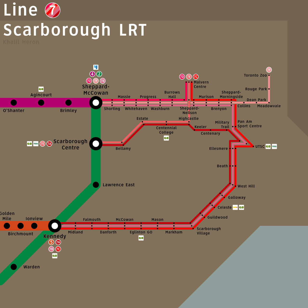

Made a second version! This one addresses some of the issues with getting between Malvern, and lines 2 and 4, as well as adding service too the zoo, and moving the station at centennial to a more central location. It is basically a combination of the Eglinton East LRT, the Sheppard East LRT, and the SRT extension.

Honestly, the hardest part of this was just deciding on colours. This is the I could come up with, though I realize it looks like the lesbian flag. I've tested it and it should be legible to most colourblind people, but if not the numbers and the letters should help with that.

The new alignment for the STC-Malvern and STC-Kennedy sections now runs parallel to the 401, and along Neilson and Military Trail to better serve Centennial and Centenary (though the stop for centenary is 700m from the hospital itself cus I couldn't find a better alignment that would also let it hit UTSC). The new alignment also prevents the section of Sheppard from Neilson to Morningside from getting too busy. I made the whole thing run as a separate service honestly just for the branding cohesiveness (Eglinton line that runs from Sheppard and McCowan makes 0 sense) but it makes sense to have it separate as it is more impacted by traffic (most of it being median running and all) so we wouldn't want it to slow down the rest of line 5. That being said I think trains from each line could easily interline and continue past Kennedy in either direction (like how lakeshore east and west interline) just not every train.

Actually, the colors look great!
And I like your route from Neilson to UTSC. Originally I thought of it being placed right next to the 401, on its south edge. But now I see that Neilson + Military Trail makes more sense.

Yea thanks i think it offers some better service than along the 401 and gets passengers a little closer to centenary even if not to its front door
