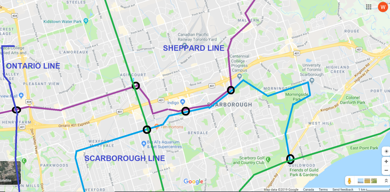

It's been talked about before, but I've firmed up what I really think the most appropriate course of action for Scarborough is. Essentially the Wye proposal, using high floor LRVs to reduce conversion costs but maintain commonality and allow less than total grade separation. IMO it would be entirely possible to market this thing as being the same technology as the Ontario Line at this stage (yeah, that's probably using trains not intended for street running, but intentions aside current High Floor LRVs and light metro units are basically identical in size, capacity and performance).
I'd drop the RER Lawrence station but re-locate Agincourt and add one at Finch and time construction so that the SRT shutdown is delayed until (short of the trains falling apart :mad:) the Eglinton East extension opens first and bus priority (if not fully dedicated lanes) is available on Kennedy and Progress.
Edit: pasting the map in
199851

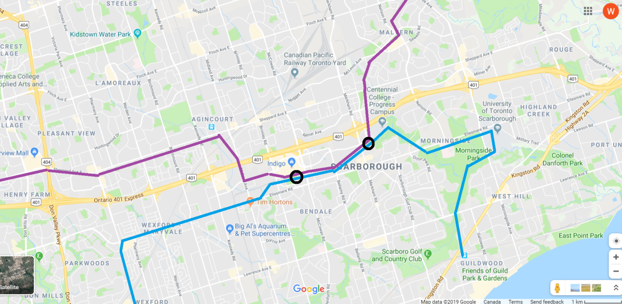

If anything, Sheppard should be converted to the same trains as the Ontario Line.
Sheppard Line would become elevated just before 404 (I don't know the exact location and depth of the Fairview Station, but I am imagining the line switching to the south side of Sheppard and crossing on a bridge roughly at similar elevation to the roadway bridge). It would continue elevated (mostly on the south side) until just after Kennedy, where it would go down to STC and then up to Malvern (Finch and Morningside). The "other" line, would go along Ellesemere, dip up to STC, and then Centennial (close to 4 parallel tracks in the 2.5km between STC and Centennial), and then dip down to UTSC and LSE-GO. All lines grade-separated.
199877
