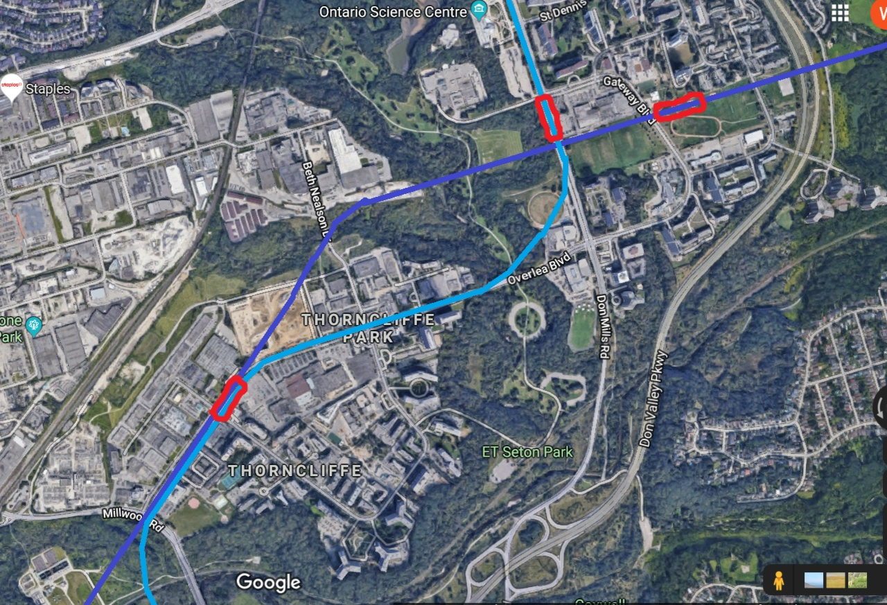

A bit more detail around Throncliffe. The Ontario Line (OL) would have stations at Don Mills/Gateway and Eglinton. The Scarborough Line (SL) would have a station at the East end of the same mall at Gateway/Hydro corridor. Basically, we are pushing a transit line through the neighbourhood, so it becomes much more palatable to the locals if they can actually use it with a stop.
They would of course share the Thorncliffe Station at Overlea and Throncliffe (west branch). As a side benefit - this also provides better access to the planned train yard location.

At Throncliffe Station itself. The two OL tracks would be roughly in the median. The two SL tracks would be roughly above the sidewalks. The Southbound platform would be above the SW (southwest) bound Overlea Blvd lanes. The Northbound platform would be above the NE (northeast) bound Overlea Blvd lanes. There would be a cross-over tracks just NE of Overlea Station, so that in the interim, SL trains could use the OL tracks to head downtown. The full station could be built in phase 1, with the SL tracks SW beyond the Station being built in phase 2.
The Station elevation would be a few metres higher elevation that that of the approaching OL tracks. NE of the Station, the OL tracks would dip a couple of metres, while the NE bound SL tracks would climb to elevate over the OL tracks. Similarly in the SW, the OL tracks would dip a couple of metres, while the NE bound SL tracks would be elevated over the OL tracks.
The locals will not accept two elevated lines along Overlea Blvd.
If locals don't want additional transit, I think it would be easier still just to go straight down Don Mills to the Valley, and then follow the valley. If the locals don't want the $200M station and tracks, I would be just as happy to save it.
