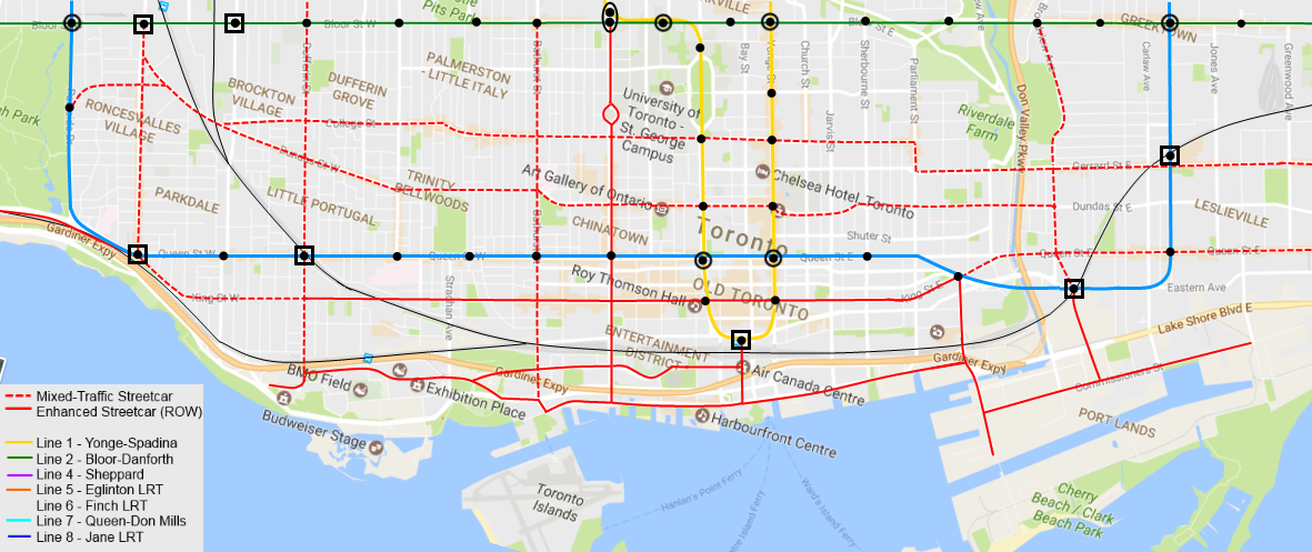

This is my fantasy map(s). I was reading the Waterfront Reset report and it struck me how convoluted and confused all the different schemes were for trying to add a waterfront streetcar network, and how they didn't take advantage of a possible reorganization of the streetcar network due to the presence of the DRL. This is my response for how the waterfront network could be laid out in a way that makes sense to me.
This (http://www1.toronto.ca/planning/3-rightofway-widths.pdf) was used in planning where ROWs were put for "Enhanced Streetcars" or for where "LRTs" were placed.
Downtown
I envision 3 new routes:
515 - DUFFERIN
Route:
-Follows existing 29 Dufferin route to Dufferin gates
Grade separation:
-sufficient ROW for reserved lanes north of Lawrence
Benefits:
-upgrades busiest surface route to increase capacity/comfort
518 - BREMNER
Route:
-Starts from DRL station, goes south to dufferin gates, east to service Exhibition, then goes under the Gardiner -> Fort York -> Bremner -> Union station
Grade separation:
-from Fort York east, descends into a cut-and-cover tunnel (room for stations has been provisioned for in buildings along the route)
Benefits:
-provides long planned for Bremner LRT
-services SouthCore and big events (CNE grounds, BMO fields, Skydome)
516 - BROADVIEW
Route:
-South from Broadview station to Unilever DRL station. Follows extension of Broadview avenue south to commissioners
-West from there to Cherry, then up Cherry ROW to terminate at Sumach DRL station.
Grade separation:
-South and West of Unilever DRL station, entire route is in separate ROW
Benefits:
-Serves Unilever development (like Southcore, new CBD planned à la Canary Wharf in London)
-people heading downtown would transfer at DRL, so route isn't indirect compared to other schemes
-provides direct route to subway for people in the portlands

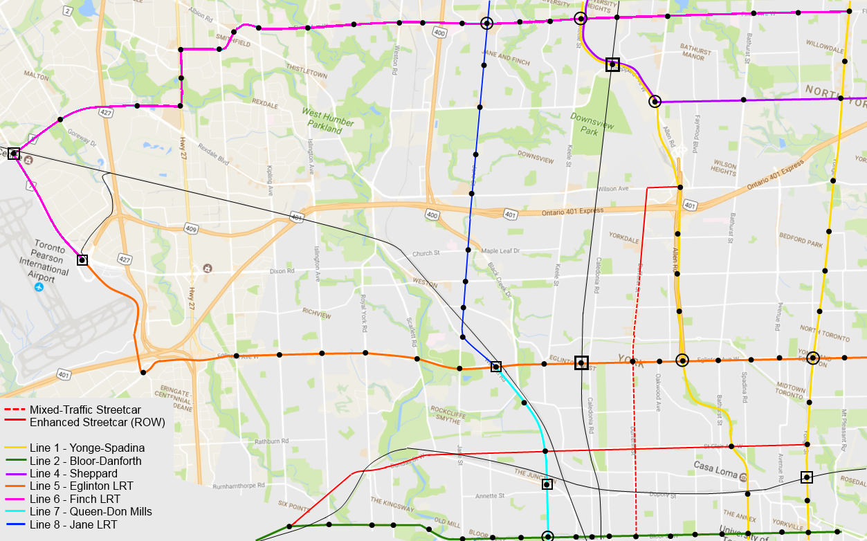

Toronto North West
Salient Points:
  • Dufferin upgrade to streetcar, as described above, to support intensification of corridor. Separate ROW north of Lawrence.
  • 512 St. Clair ROW extended west to Scarlet Road and then south west along Dundas to terminate at Kipling station, to support the 6 point redevelopment.
  • Jane LRT, rather than continuing south from Eglinton (where ROW constrains means it would have to be buried) operates as a branch of the Eglinton LRT (half of the trains from Mount Dennis continue west to the airport, half go north). Jane LRT terminates at TYSSE station Pioneer village at Steeles.
  • DRL is extended north from Keele to Mount Dennis, providing service to the Junction and reactivated cross-town RER line in the process.
  • Sheppard subway is continued west to Sheppard west station, where it interlines. Southbound from Vaughn Centre, half of the trains would go east at Sheppard towards Don Mills and the other half would continue downtown. This extension has the added operational benefit of making the Wilson Yards accessible to the Yonge line.
  • Finch West LRT is extended east to terminate at Yonge & Finch. It's extended south and west to the airport via Rexdale (intersecting Malton GO).
  • Eglinton West LRT is extended to the airport, with a maximum of grade separations. Connection to Missisauga transitway not shown.
Downtown
515 - Dufferin
Route:
-Turns east to service Exhibition, then goes under the Gardiner -> Fort York -> Bremner -> Union station
Grade separation:
Benefits:
-provides long-dreamt-of Bremner LRT
516 - Broadview
Route:
Grade separation:
Benefits:

Toronto North West
Salient Points:
