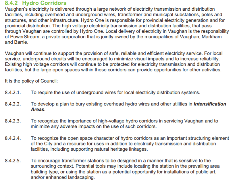

They already have. Over or under. There's no other way to build subways north without crossing those Rights of Way. Unless they move the pipelines further north, but that just kicks the conundrum up the road.
Ostensibly the 'utility corridors' would minimize interaction, but some is inevitable. HV xmssn corridors have been used for rail for a century or more, much of the Penn Mainline is exactly that.
Hydro One's transmission corridors, or Right-of-Ways (ROWs), are essential in delivering safe, reliable and affordable electricity throughout the province. They allow Hydro One 24/7 access to the towers and lines for routine maintenance and in emergency situations.
Many ROWs also have sufficient space to provide for expansion of Hydro One's facilities to accommodate future growth. The ownership of ROWs is diverse and includes government, Hydro One, private property owners, railway companies, and Indigenous communities.
The Ontario government has established a Provincial Secondary Land Use Program (PSLUP) that allows for the use of ROWs, while taking into account the primacy of use of these lands is for electricity transmission and distribution.
Hydro One strives to work with proponents to review secondary land use proposals on the ROWs so that they are compatible with the safety and maintenance requirements of our high-voltage equipment.
https://www.hydroone.com/business-services/secondary-land-use
