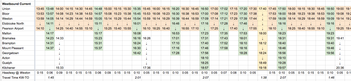

According to the mini schedule, see link, the GO trains leave Weston Station at 6:12, 6:30, 7:07, 7:32, 8:00, 8:30, 8:53, 9:34, 10:29, 11:34, 12:34, 13:34, and 14:34 and nothing after. With UPX, it leaves Weston Station at the x:44, x:59, x:14, and x:28, from 5:44 until 1:14.
You can also check out the full combined Weston corridor train schedule, which I posted on page 543 of this thread.
The problem is that GO trains accelerate much more slowly than DMUs, which results in longer travel times from Weston to Union. As a result, the off-peak trains are completely useless for Weston-Union trips: even if one does happen to show up, you're still better off waiting for UP.
