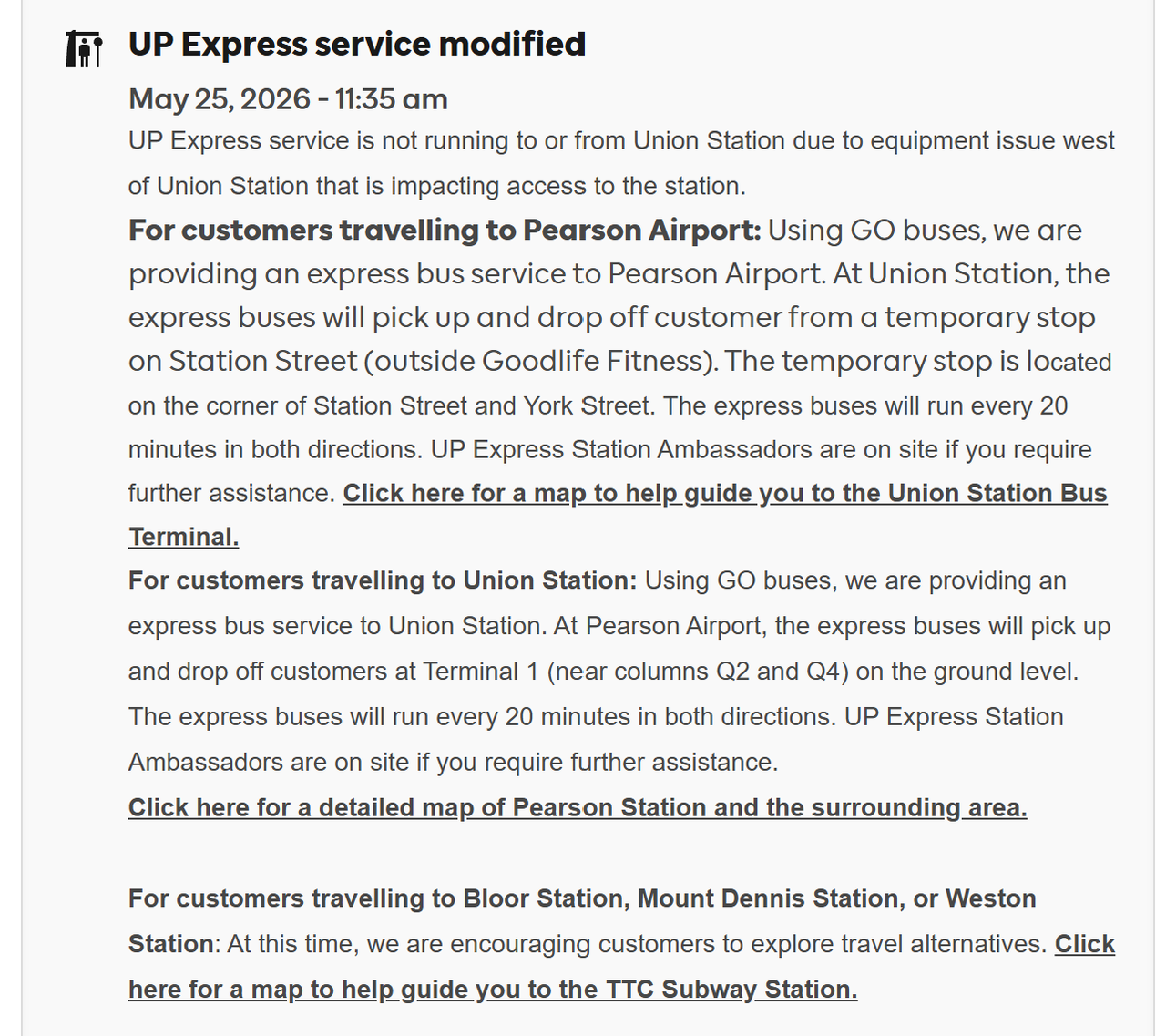

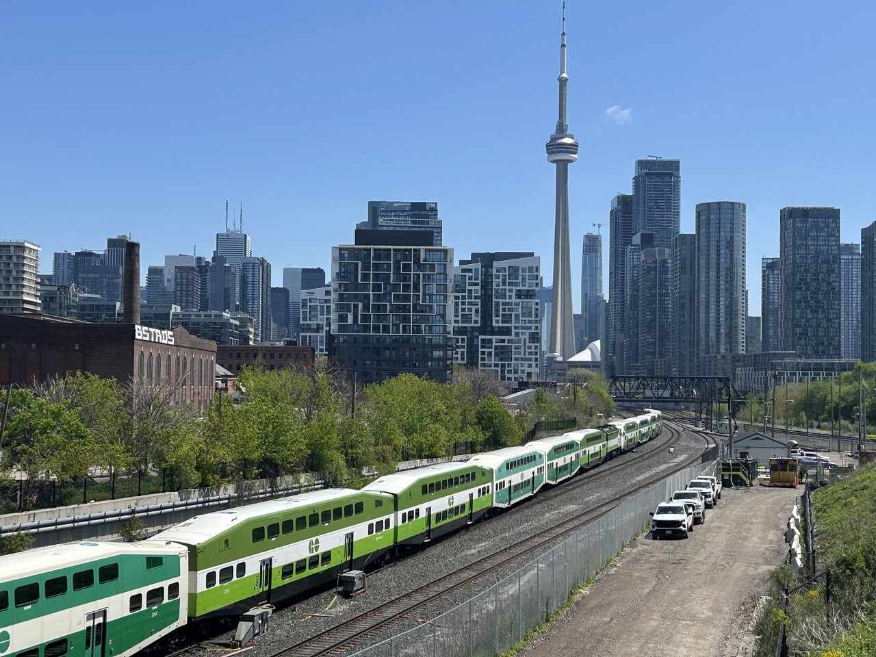

Nope. It was a stalled GO train that died right on the key crossovers at Bathurst St. Seems to be taking forever to get a rescue train hooked up to drag the dead train away.
