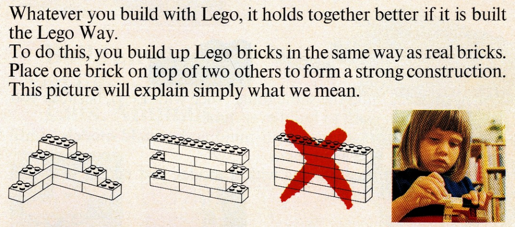

I shudder when I look at the precast panels. I can't help but think that the Very Clever Architects failed Lego 101:
The 'Lego way'......... by which we mean stretcher or running bond wasn't invented by Lego, of course.
English bond is another traditional, strong one.
It generally does look better (more realistic) than stack bond. Of course, stack bond is a real brick laying pattern, but one with lower structural integrity.
Stack makes more sense for something bearing little weight, or none at all. Something like an accent wall, often superficial, (with a structural wall in behind), but could be used in a non-load bearing scenario on its own. One would want to carefully consider how it is adhered to any underlying surface.
I had presumed being precast that it doesn't really matter what it looks like on the outside, that it's the material of the precast itself that holds its integrity. So that the bricks can be stacked in anyway within the precast has little to do with its strength to my understanding, Lego way or otherwise.
I dunno, I'm just not thrilled by this particular facadectomy. I dunno if matching the colour of the brick would have helped. But U of T itself has many better examples.
On the tower, the precast is a vertical running bond - something that cannot be achieved with veneer masonry. On the podium, the stack-bond artisanal brick has too much depth to its face to have been used in a precast system (concrete would leak around the sides of the form liner and pool on the face of the brick). Each system is showing that it can do what the other cannot.
The townhouse was a last-minute change to thin brick on precast, so it doesn't follow the same logic.
