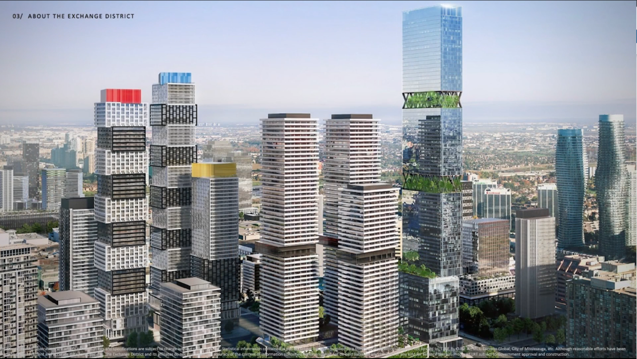

Render of The Southlands from this video @ 29mins 5secs.
first suburban supertall in North America? If I had to bet on a location, Mississauga would be a good one to pick..

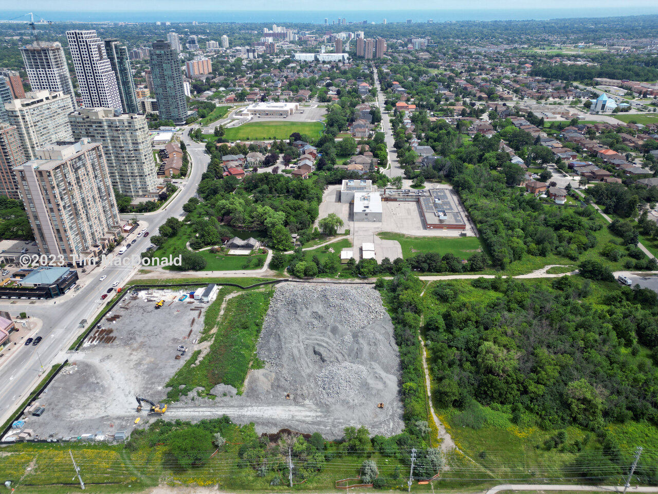

The Site Plan Application for what I believe is this site indicates a 72-storey building, which likely wouldn't hit that supertall status. It does look like it may have a decent office component in the podium levels though so that may push it up in height.. hard to say.
3672 Kariya Drive
DESCRIPTION: 4 residential towers with 60, 60, 40 and 72 storeys with at grade retail for 3 towers.

The caveat here is that 111 West 57th Street (NYC) only has 80 stories despite being 435 metres tall. So that's not outside the realm on any possibility here...
...but I also agree that this seems way too ambitious for this city. And that rendered shiny tower in question suspiciously looks like a placeholder trolling for the woos. /sigh

NY is an oddity. Due to their density zoning and land-assembly challenges, much of the cost is per-floor rather than by height.
Building a 20 floor building on giant stilts (I.e. a 300m tall lobby) was getting close enough to being reasonable in billionaires row that the city specifically outlawed it a few years ago.
In short, unusually tall ceiling heights aren't unusual in Manhattan.
Greater floor heights are typically for higher end buildings. The units in such buildings will have higher ceilings which means fewer floors and fewer units. These are intended for high net worth end users.
This is very different from this building which will be mostly investor owned rentals. These units will be getting standard 8-9 foot ceilings, meaning more floors and more units.
So this won't be 400 metres or even 300. The typical residential level in a mainstream "production" building is 3-3.2 metres, making this one around 220-230 metres.
As @innsertnamehere alluded to, the office component may boost the height. A typical office floor is 4.5-5 metres. Assuming five office floors, you get 24 ish metres for a grand total of 250 ish. Really high, but not quite supertall (300 metres) if we're being pedantic.

That's great knowledge there I did not know. And thanks for that! But it still stands that they could stretch 72 floors to break 300m mark if the devs here choose to do so...
...whether it's in their best interest to do so is another matter. 😺
