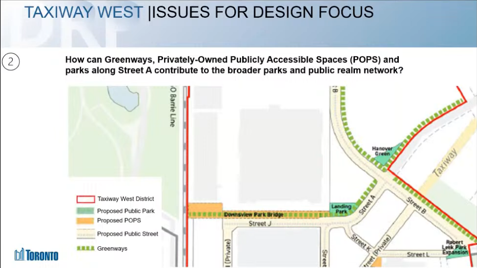

Bridge over GO Line - detailed vision: Aspiration to High Line, not replication but inspired by, bridge to be ~30M wide and able to support substantial, mature vegetation on the approaches to full height, actual cross of track more conventional.
Any clarity on which streets buldings are fronting onto vs rear-facing. Confusion due to unconventional street grid. Streets D and Taxiway to be more important, but all blocks are to be considered important for frontage purposes.

Concern about width of proposed pedestrian bridge. At ~30M, wider than the Gardiner Expressway. Maybe narrower would be better.
Concern that length over 4% grade may be the definition of accessible but makes for very long pedestrian trips, need for supplementary stairs/elevators so that pedestrian trips can be more efficient.
Street A could be a more generous greenway, better connectivity between parks.
Taxiway street character cannot be entirely vast and treeless, but maybe could better exhibit that massive, industrial scale on one or more blocks within the first phase.
