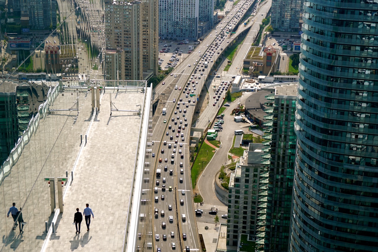

Finally, when the towers open, it looks like you'll find that the number of floors will be higher by 5, not because they're skipping 4, 13, 14, etc., but because they've started the residential towers at a higher floor count to take into account high floors in the podium. I only know that now because I shot this when touring the building: suite 4402 is on what is actually the 39th storey.
For those wondering how that all works into how many floors are left to build now? Sorry, I asked when I was up top, but the answer came back in an uncommitted way. "We're on the 64th or so on this tower and, uh…" So, whatever it is exactly, there are only a couple more to go!
The price list I received recently has some units for sale on floor 70,, not including the penthouses.
Any idea, what is the first residential floor? for Ten York for example the first residential floor is '8'
My note about about not skipping 13 might be wrong: that might be skipped. We just know that the 4s aren't being skipped because 39 is now 44.
So following the 5 floor difference at that height, 70 is actually 65, and must be the East Tower as the West Tower only goes to 63, including the penthouses. With the East Tower actually having 67 storeys, there can only be two more above "70" for the penthouses.
So, not knowing whether they skipped 13 or not, no, I don't know what level the suites start at. Sorry!
So the floor where your recent pics are taken from is actually 44 or 54 but not 49!
Harbour plaza add 5 to the actual floor and Ten York add 3, I believe its somehow related to the podium height.
The first floor is 10th.
Only number 13 is skipped.
I know because they tried to sell me the 10th floor which is right next to the Gardiner. It has a full wrap around balcony on the entire floor.
That was actual 49. They're using actual floors for the forming crews, and then spray painting suite numbers on the walls correspond to the marketed floor number for the crews fitting out the suites.
