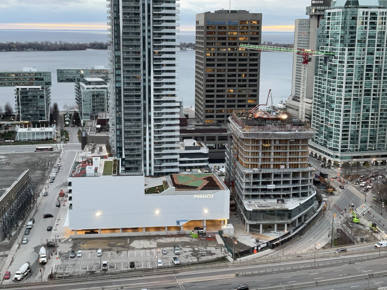

Just asking questions? The excavation photos explicitly show the bottom level of the basement garage dug into the shale bedrock. Not all major buildings are anchored to bedrock in Yorkville. Yorkville can be considered both downtown and not downtown so saying all major buildings anchored to bedrock can be both right and wrong.

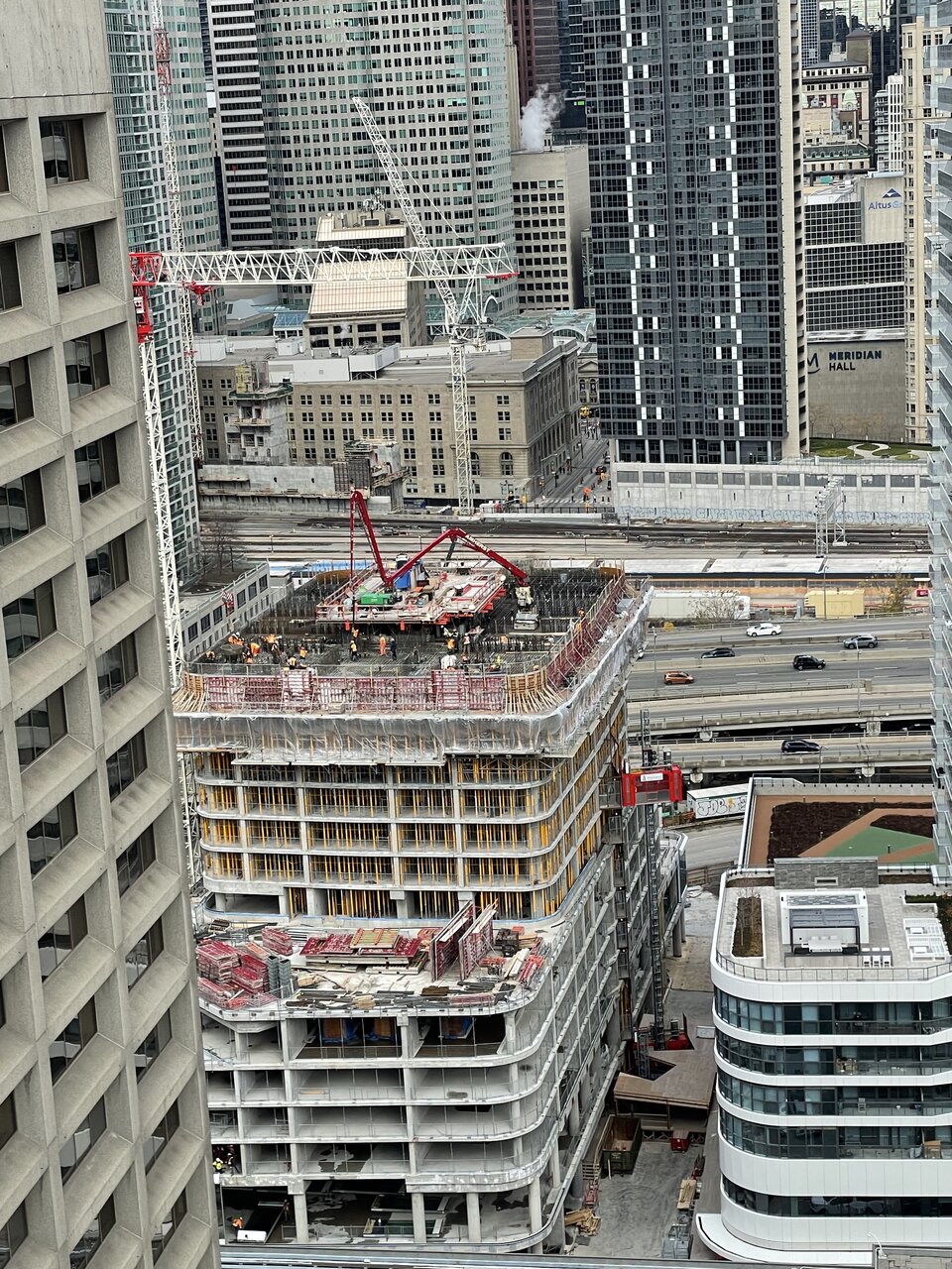

...oh, that sounds like something is about to be poured big time. <3
A very very long pour.

By downtown, I suppose I meant below Queen where the Georgian Bay Shale formation is relatively shallow, but I should have been more specific. Having said that, many of the larger buildings up at Bloor are also founded on bedrock through piles. I am petty sure that is how "The One" is built.
