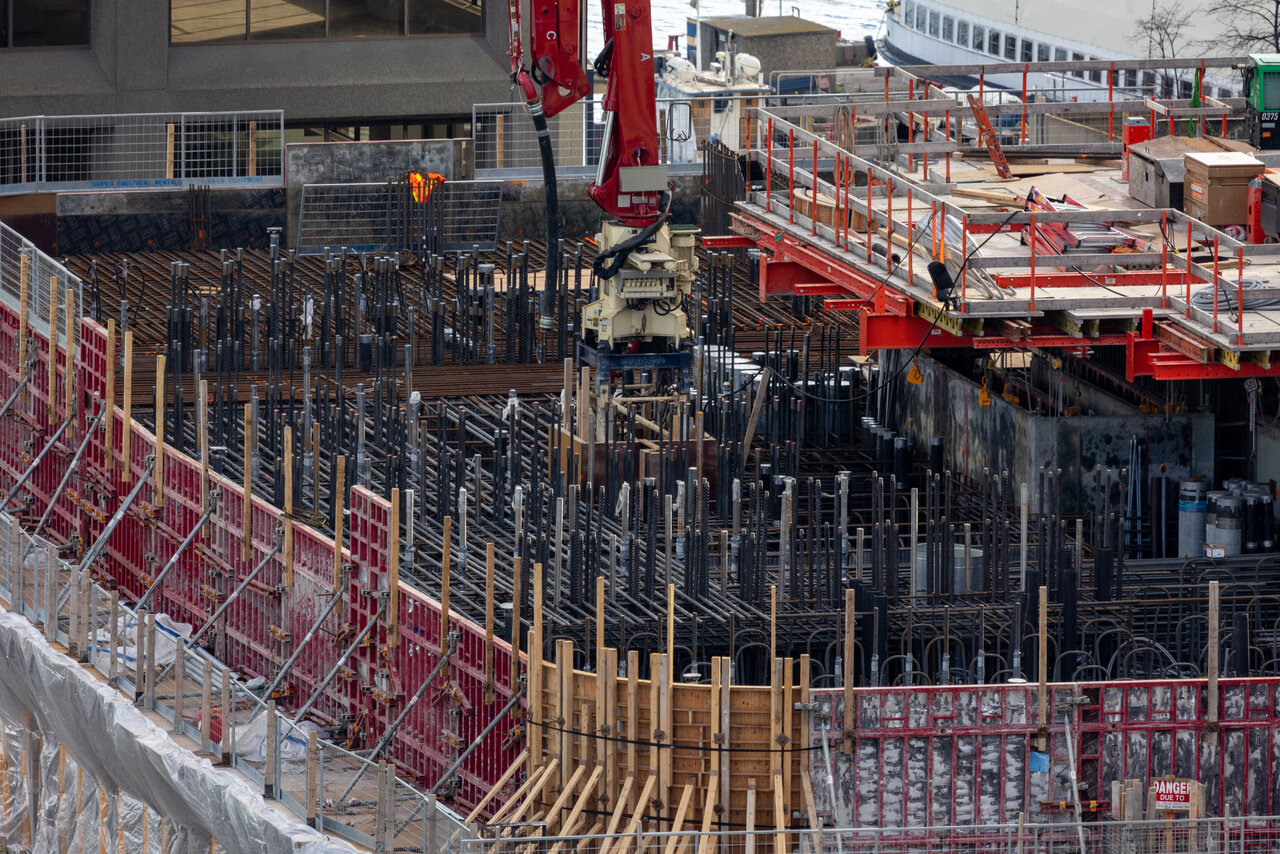

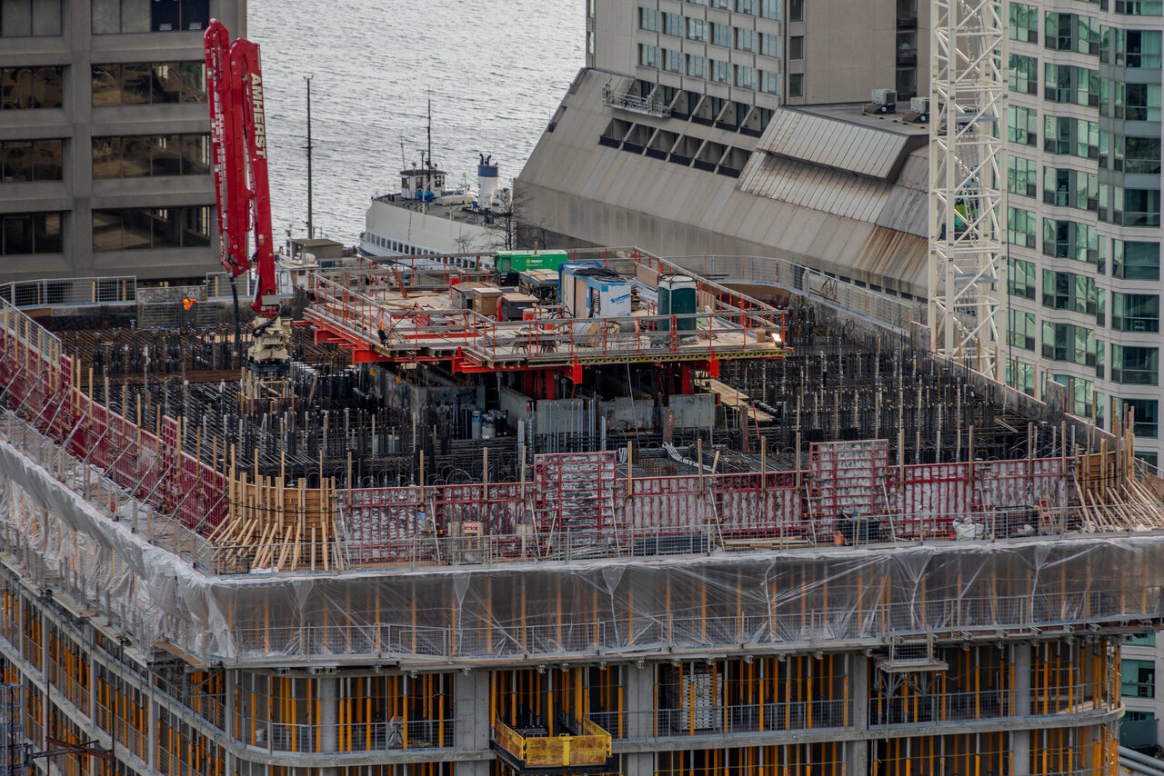

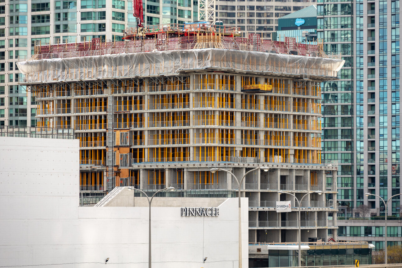

2 weeks since my last update on Nov 8 and 2 months into this slab from Sept 22 and they still have more steel work to go.
Pictures from Sunday Nov 19.

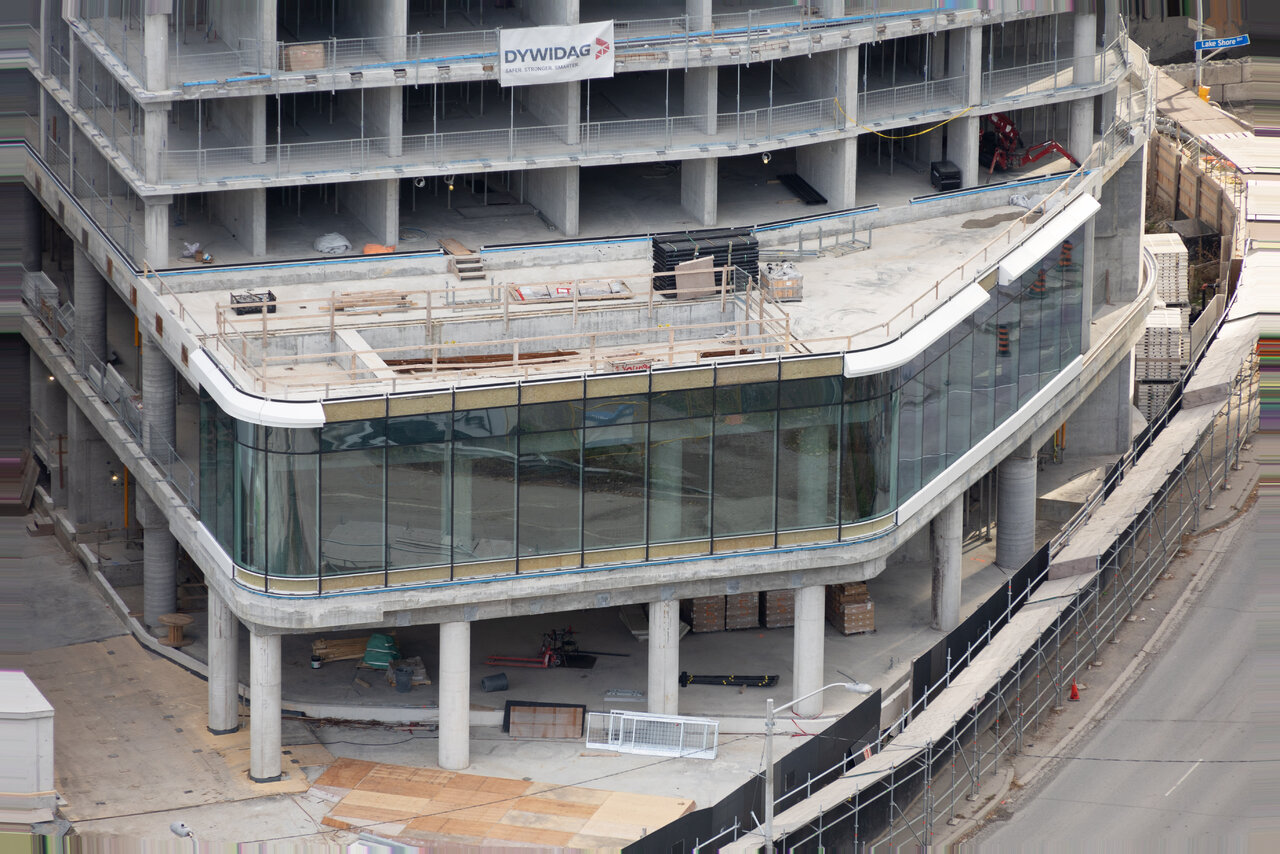

DYWIDAG or is that WYSIWYG
From Front St. It’s a beauty.
New sign

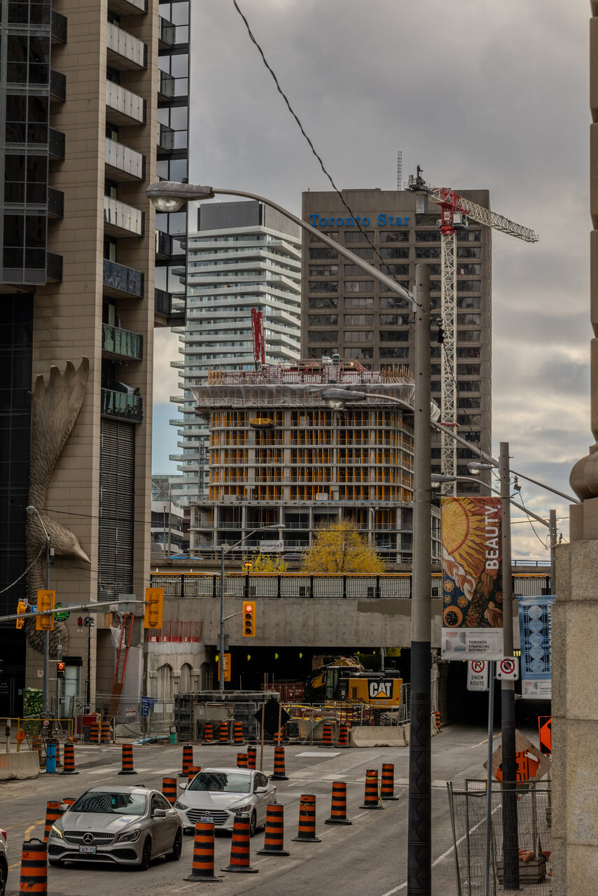

From Green P lot.
I’m less worried about the street level now with how good the cladding looks for phase two. Hopefully when this is all finished the podium will come together nicely.

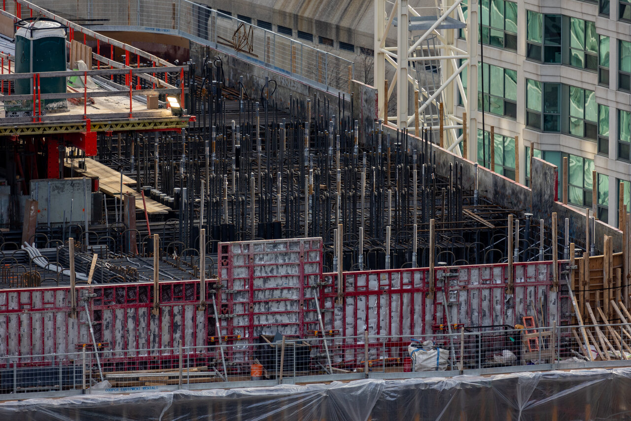

...I mean, other than the pipe organ like rebar being used here, Phase 2 is not offering much in the way of construction novelty like The One is.
Why is the glass green? I don't remember seeing that in the renders at all.
It does look a little green from certain angles, but from other angles it's mostly the colour of whatever is reflected in it, which does include some existing green buildings. It has more of a blue/silver look when reflecting the sky.
I'm curious how much time is saved by tarping the sides of the transfer slab floor, once the pour commences. Does that dramatically improve curing time? If so, does anyone know by how much, or would it not be possible to cure concrete in low temperatures without it?
There are gas heaters inside the tarped floor, they are setup when there is a possibility of snow/ice/frost and must be turned on before there is any buildup (especially on a slab this size) otherwise the snow/ice will never melt as there will be an insulating layer.
Concrete needs 10°+C to cure so heating the deck underneath will certainly help, as well as using a winter mix.
