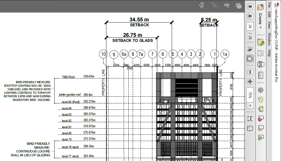

Here's the top of The One:
You'll notice on the left above that the "TMD Roof" (that stands for Tuned Mass Damper) is at 305.6 metres. On the right, you'll see another 3000 millimetres are to be added for the top of the super-column structure, so a total of 308.6 metres, or 1,012' 5 ⅝".

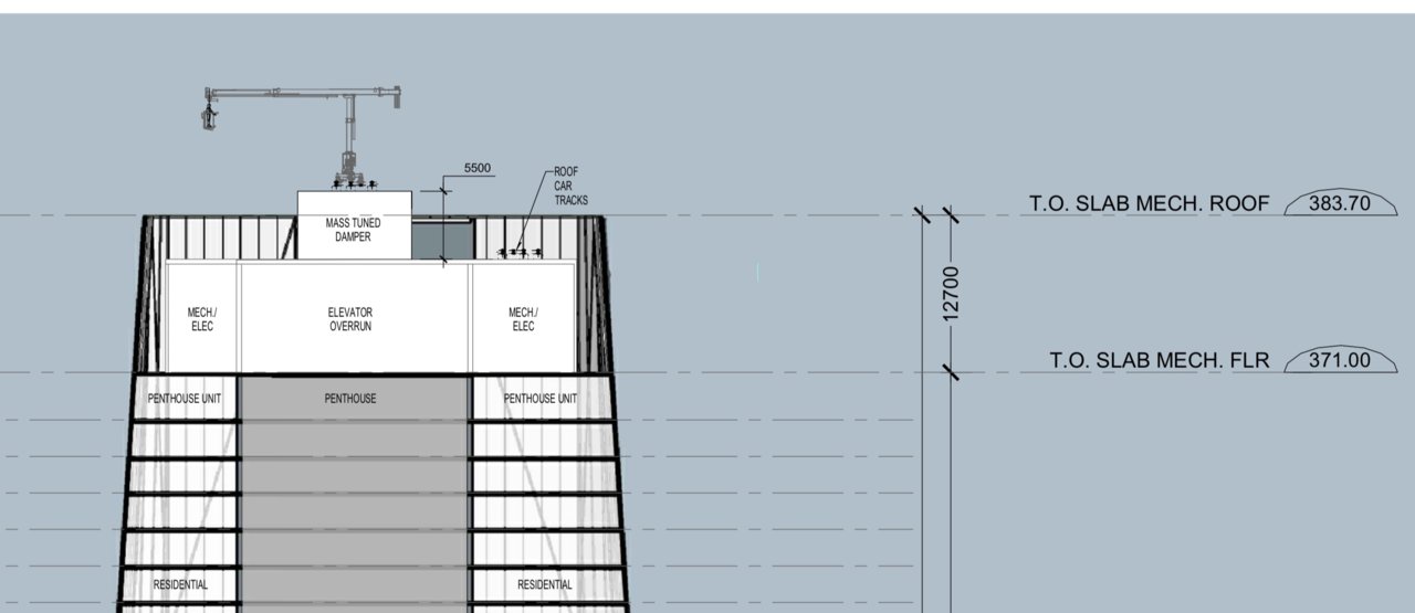

The top of Pinnacle One Yonge's Sky Tower appears on its Architectural Plans on the City's site as below.
That "Top of Slab Mech Roof" is 383.7 metres. That's above sea level. It shouldn't technically say Slab Mech Roof though, it should say Screen, which the actual mechanical roof slab sits below by a few metres. Anyway, take away ground level of 76.8 metres and you get 306.9 metres to the top of the screen. So, that's 1.7 metres shorter than The One.
Thing is though that there's a tuned mass damper on the roof of this tower too, and we we can see it's 5.5 metres high, but we don't know exactly how far it sits above the screen… but using a ruler to compare heights on this not-legal-document, it appears that 2 metres of the TMD's 5.5 metre height are sticking out above the screen. That would make the height 308.9 metres, or basically 1 foot taller than The One.

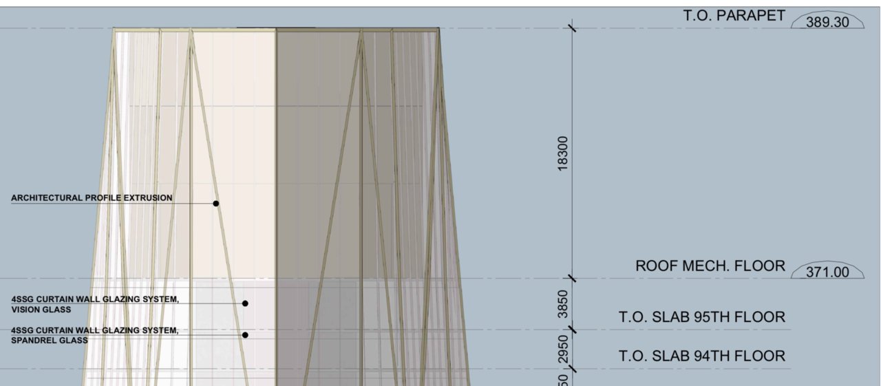

Way back in February, I posted the above when Pinnacle started claiming that this would be the tallest condo in Canada, and they claimed the tower would be 313.4 metres high, but they had only misread documents to back up their assertions.
Now, with the new SPA application in, the updated documents show what they are really shooting for. With a much taller upper section now to completely hide the building maintenance unit from view when retracted, the top of the parapet will be at 389.3 metres above sea level (the mechanical floor slab is still at 371 metres above sea level, as per one of the images above), so, subtract out the average grade of 76.8 metres, and you get 312.5 metres, or 1,025' 3" tall. That does make it taller than The One's 308.6 metres, or 1,012' 5 ⅝". That's shorter than the taller Mirvish Gehry tower, and shorter than 1200 Bay, but this one's heading for construction whereas those two aren't yet.
