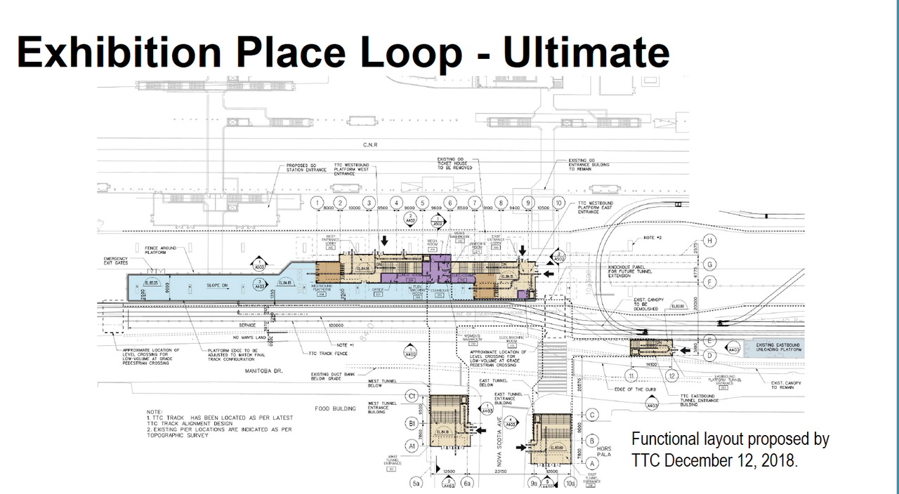

I think that this design is really a wasted opportunity to connect Exhibition with the city to the north.
The station should basically be a very wide bridge north to south, over the tracks and under the Gardner. Forget about pedestrian tunnels under the tracks. Stick a roof on it and elevators, escalators down to the tracks on either side of the bridge.  Ideally, you would lower the tracks in this section so you don’t need to go up before crossing but $$$.
It needs to be able to handle crowds from sporting events and the CNE.

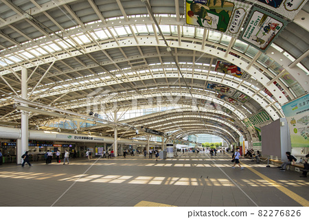

It’s a pretty common design in Japan except there would also be a department store. This is a photo I found of Saitama Shintoshin station. It’s open on both ends.
Do whatever you want with the roof.
