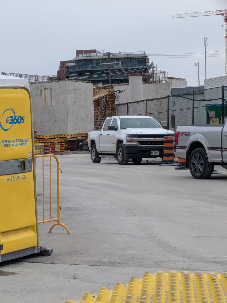

Sneaking my own pic of the Distillery Kaaba

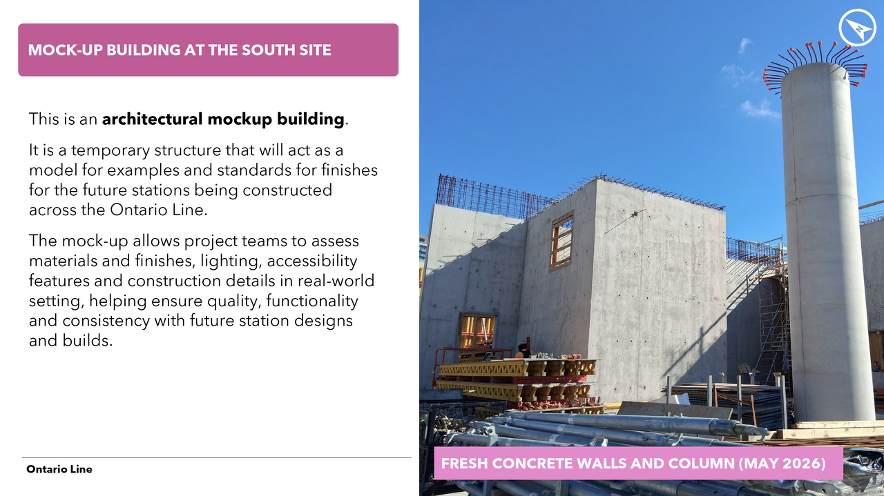

They added a slide for this in the May 28th CLC presentation deck; while it doesn't preclude other temporary mockups, the wording seems to suggest that this mockup is serving as an exemplar for the stations across the line.
