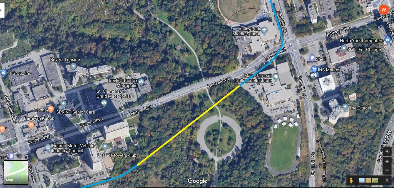

Wouldn't the curve make more sense like this?
A wider curve coming in from the south side of Marc Garneau Collegiate and heading directly up Don Mills Rd would be simpler and could allow for a station directly at Don Mills and Overlea. Gateway North and Don Mills is running into being too proximal to Eglinton for a separate station whereas at Overlea its geographically isolated from everywhere else and would command better walk-in usage.
Yes! I was going to comment on that. But the same alignment as posted by @BurlOak , but with a much softer curve. Remember, this is deep-tunnel, and able to go beneath even large buildings if need be for higher radius curves.
Yes - by far. I guess my mind was already shutting down for the day, or distracted by the Sharks-Knights game.
