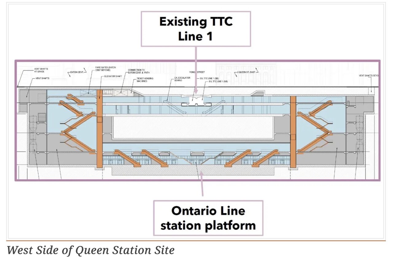

4 escalators to change lines? 6 escalators (or is it 5 escalators and a stair case) to get to Yonge Street outside the Eatons Centre?
Should be two at most. Long ones, not lots of short ones.
What happens when even one of the escalators are out-of-service for maintenance? Will they be only pairs of escalators not triple escalators? What about the elevators? What happens when one of the elevators is out-of-service? What happens when an elevator AND and an escalator are both out-of-service?
Not to worry the designer, who never used public transit in his or her life, has the answer.
