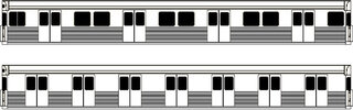

Are these doors big enough (the absolute maximum possible size (Ultra Pro Max™) vs. that of the T1)? They might as well do this then.

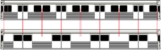

Or this (absolute minimum possible door spacing):
In both cases the ratio of total door length vs total train length is 1/2, the maximum possible value. While I personally am not a fan of plug-type doors or sliding doors that are on the exterior of the carbody (like on the original G-car prototype), they seem to be becoming more popular in other subway systems, and eliminate the need for door pockets (thus allowing extra room for windows between doors), but they still don't allow a ratio of higher than 1/2 since the doors from adjacent doorways would collide with each other.
