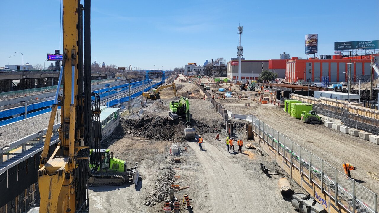

The temp ped bridge at Exhibition is open after being closed all winter and the views are pretty great now that excavation has started!
Looking East
Looking West
