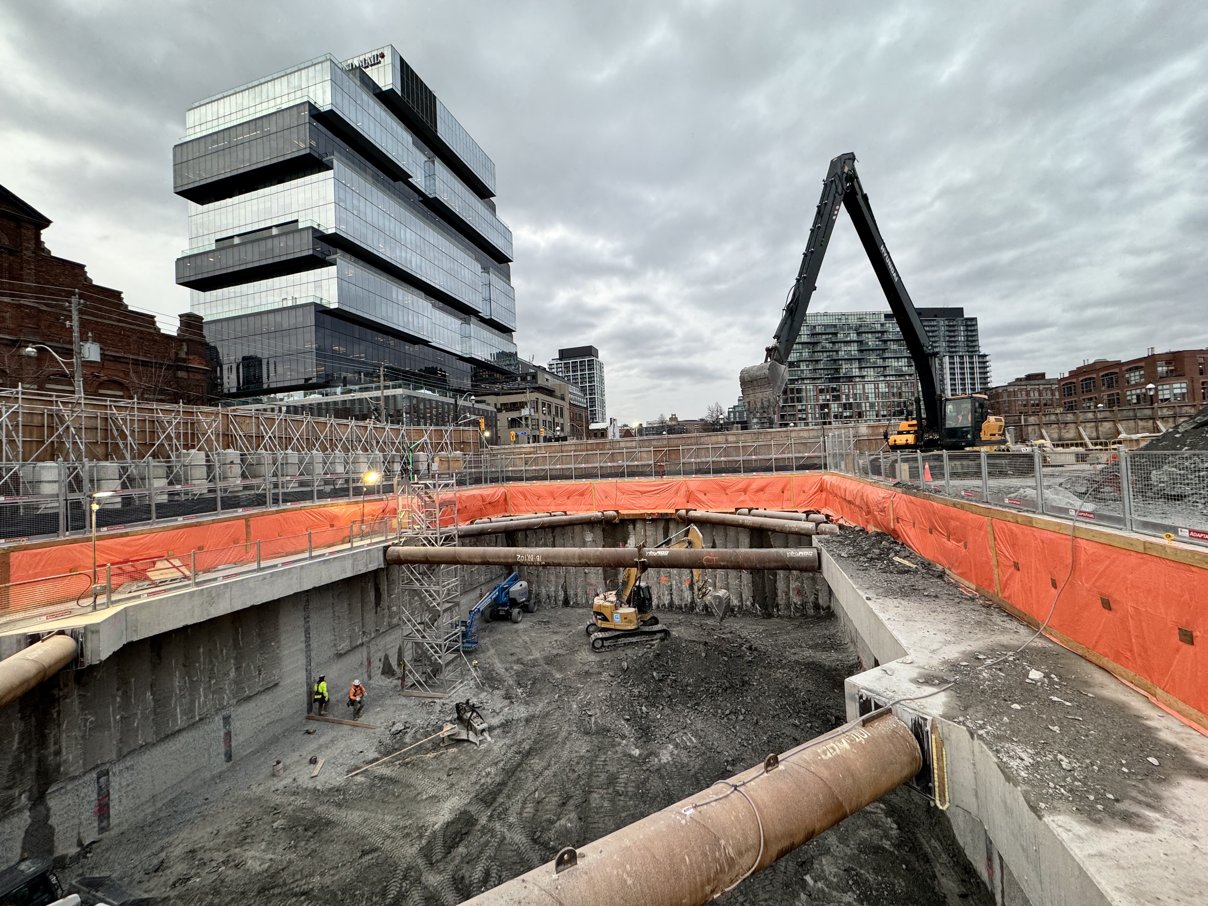

I've walked by all the downtown station sites, and I was shocked at the scale of the east end stations like Corktown and Moss Park - they are massive construction sites! (especially compared to the west end stations)
You're correct. Corktown, among many others, will be excavated where the station box will sit.
