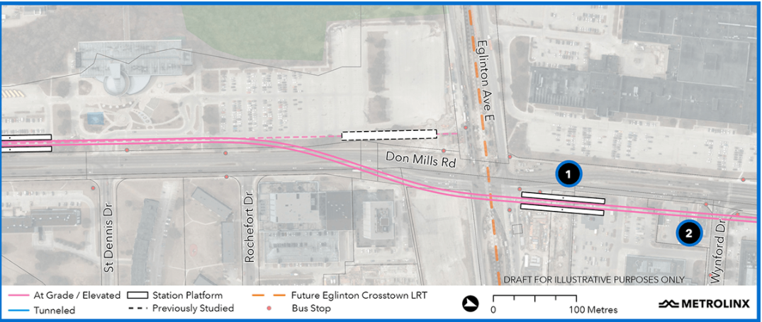

I'm worried about Science Centre Station on the Ontario Line, looks like an annoying connection as it's a bit far from Eglinton, it's actually on Wynford Drive. So from what I know, I'd have walk all the way to the south end of the platform, go down the stairs or exit the station entirely to enter the Line 5 bus terminal, go down again to the pedestrian tunnel, walk under Eglinton Avenue and a bit more to the LRT. That's a 4-minute walk for a connection. I don't like it, and it's ironic we are allowing this, but Scarborough's getting an entire subway extension because of a bad connection.
I actually think the Ontario Line be tunnelled here, this would've made more sense to tunnelled than the other places that people were NIMBYING about. It allows a better connection for riders, and it increases development potential.
And if you say that this connection is fine, it just isn't. This is one of the important stations on the line as it's the terminus, an interchange, numerous buses, and we are half-assing it. So why can't we do it right the first time??
Its not at Wynford though?
Its located on the top right corner of the intersection directly on top of the bus terminal...
