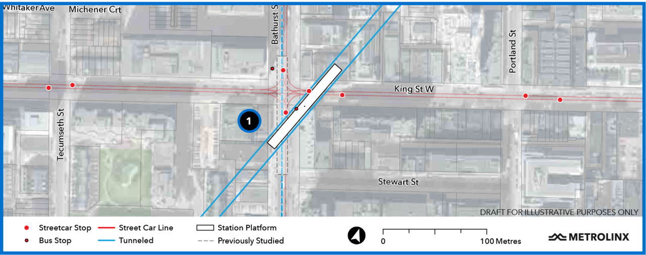

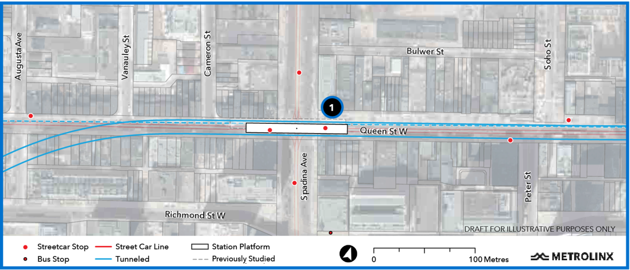

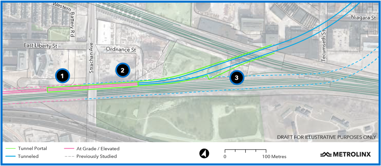

Locations of Exhibition Station, the tunnel portal, King/Bathurst and Queen/Spadina.

Why do the tracks come above ground and stop right before Dufferin? That would effectively make any kind of westwards expansion impossible. There will be a need for another north-south line to connect here, guaranteed.
