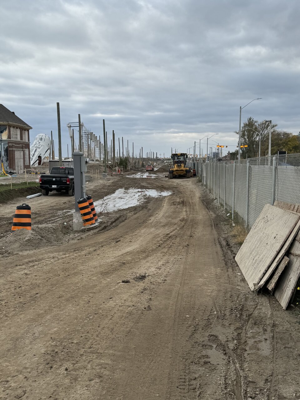

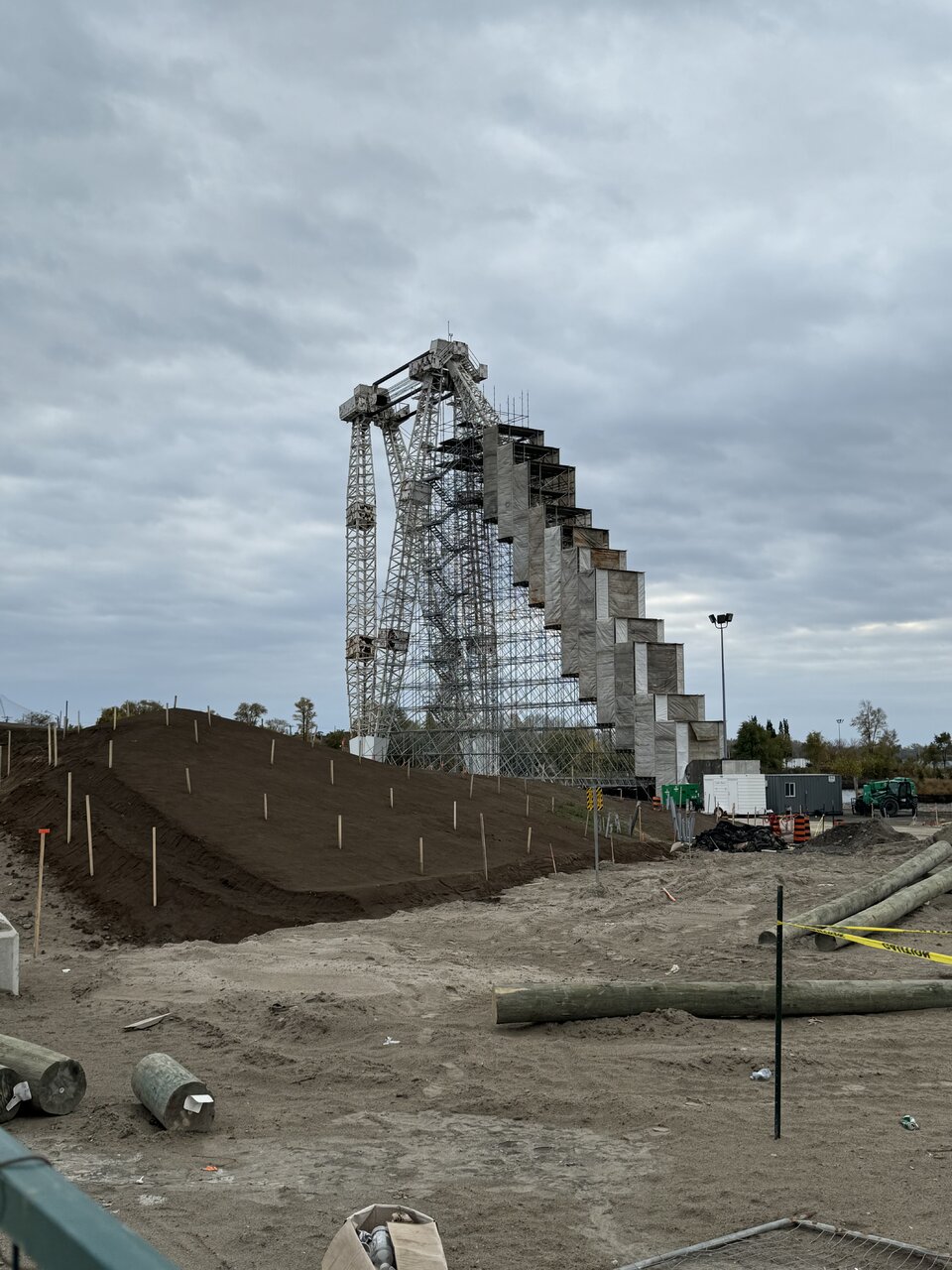

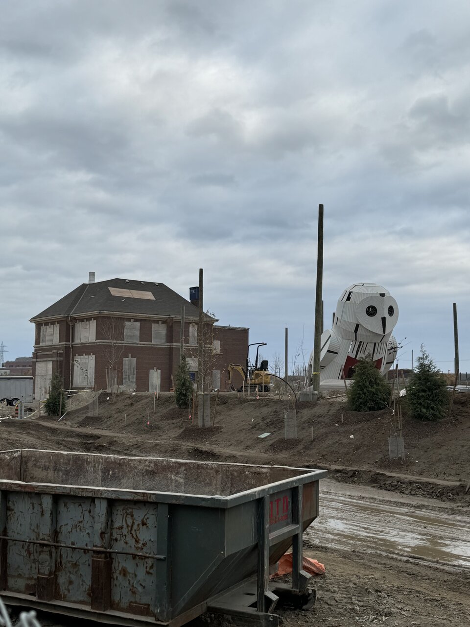

Taken 31 October.
I believe that this site has been graded since my last tour and a fence has been erected.

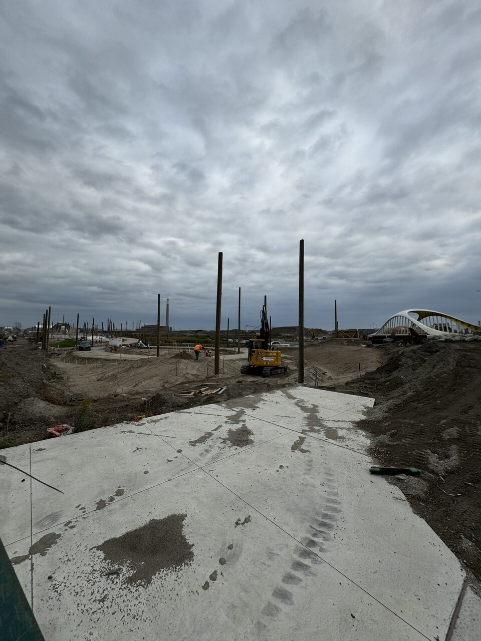

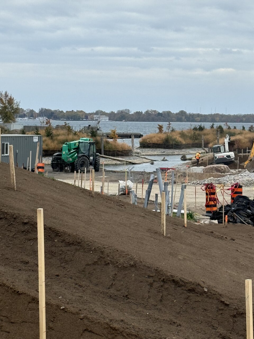

The intersection of Cherry and Polson is being worked on and will form the southern edge of the South Park.

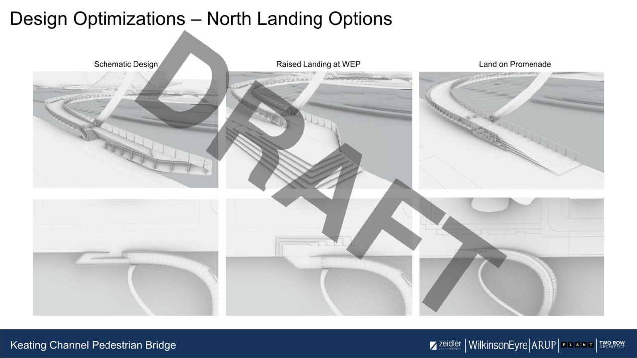

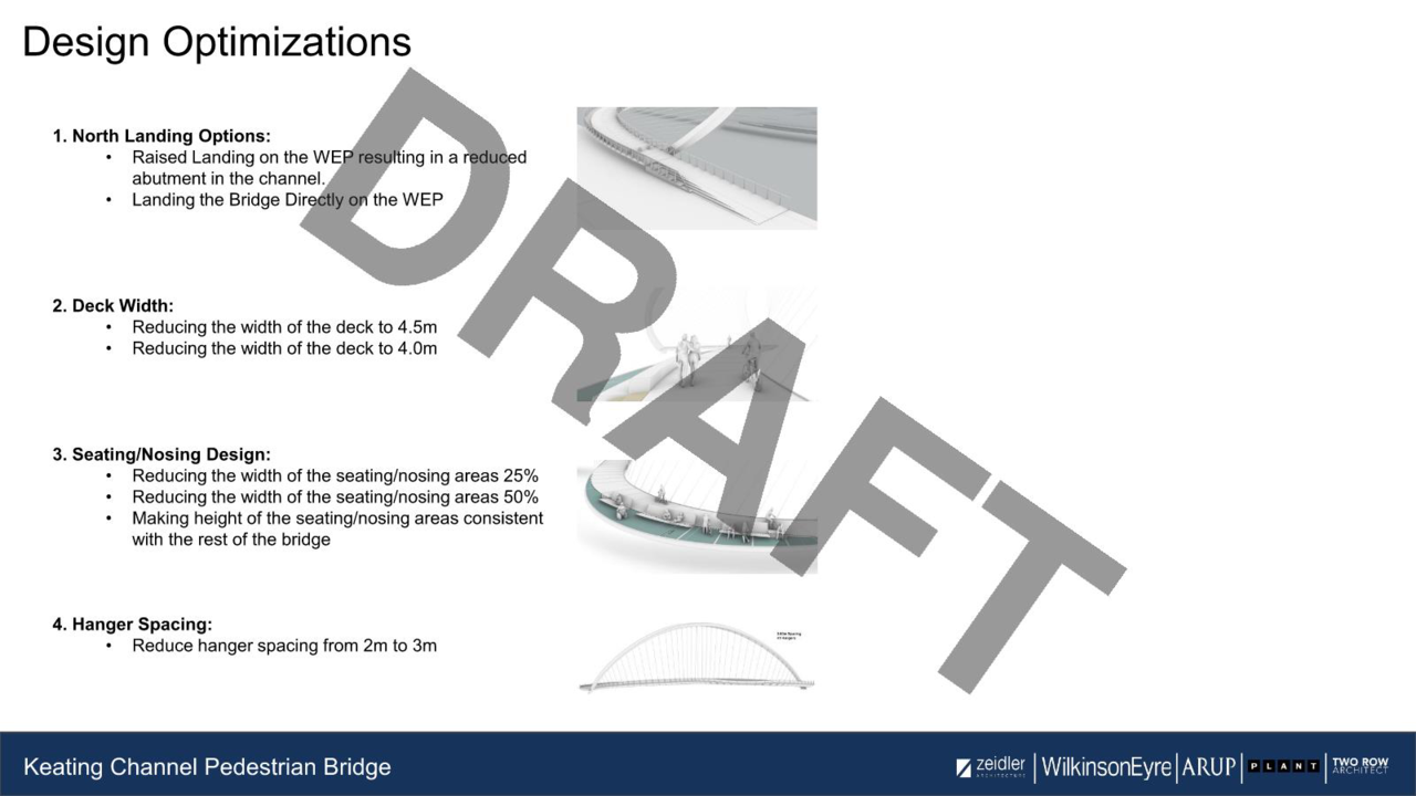

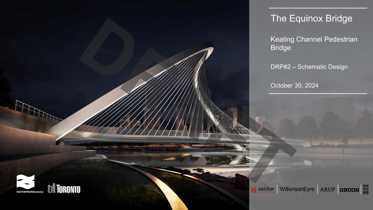

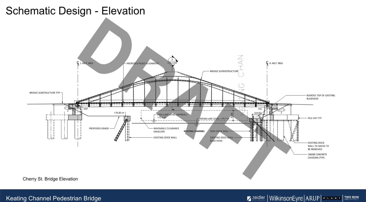

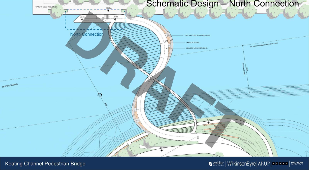

I don’t like the schematic design for the north landing. The staircase and winding ramp looks like a notable pinch point.
I can’t imagine the arguments against an extended, sloped landing on the promenade or on a separate, adjacent abutment – aside from cost (and, as stated in the slides, value engineering studies have yet to come 😵‍💫)
