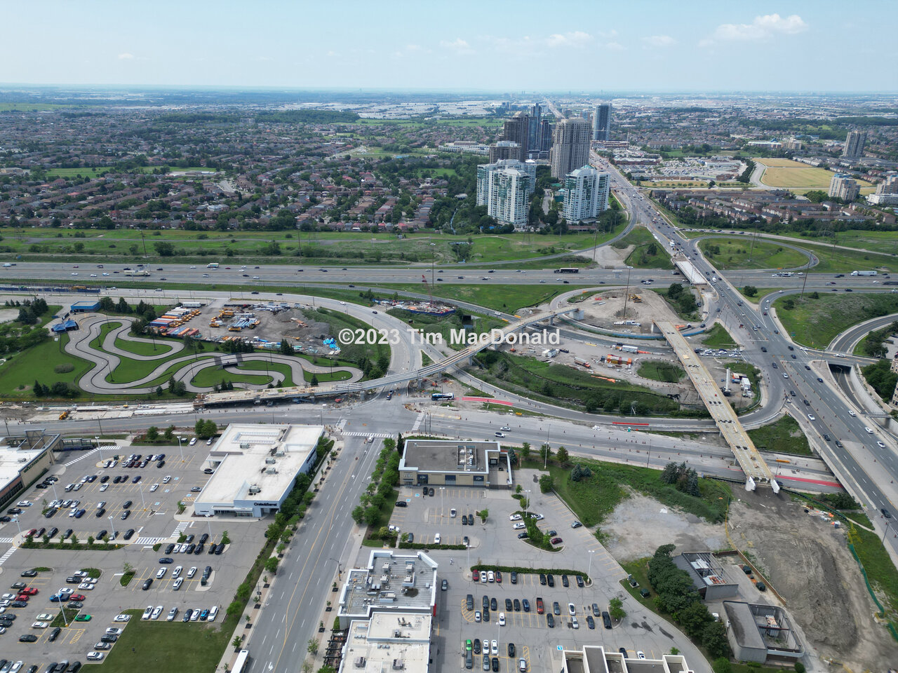

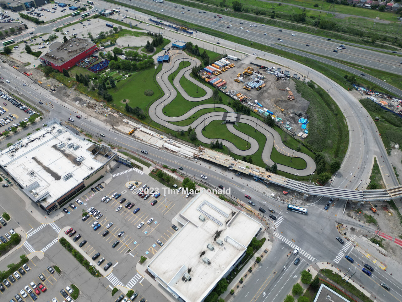

First haft of the PC station at concourse level and starting to work on the wall for the roof. the base for the push box and the barrier wall to support the pushing of the box has been removed with some grading for the rest of the station up to the push box.

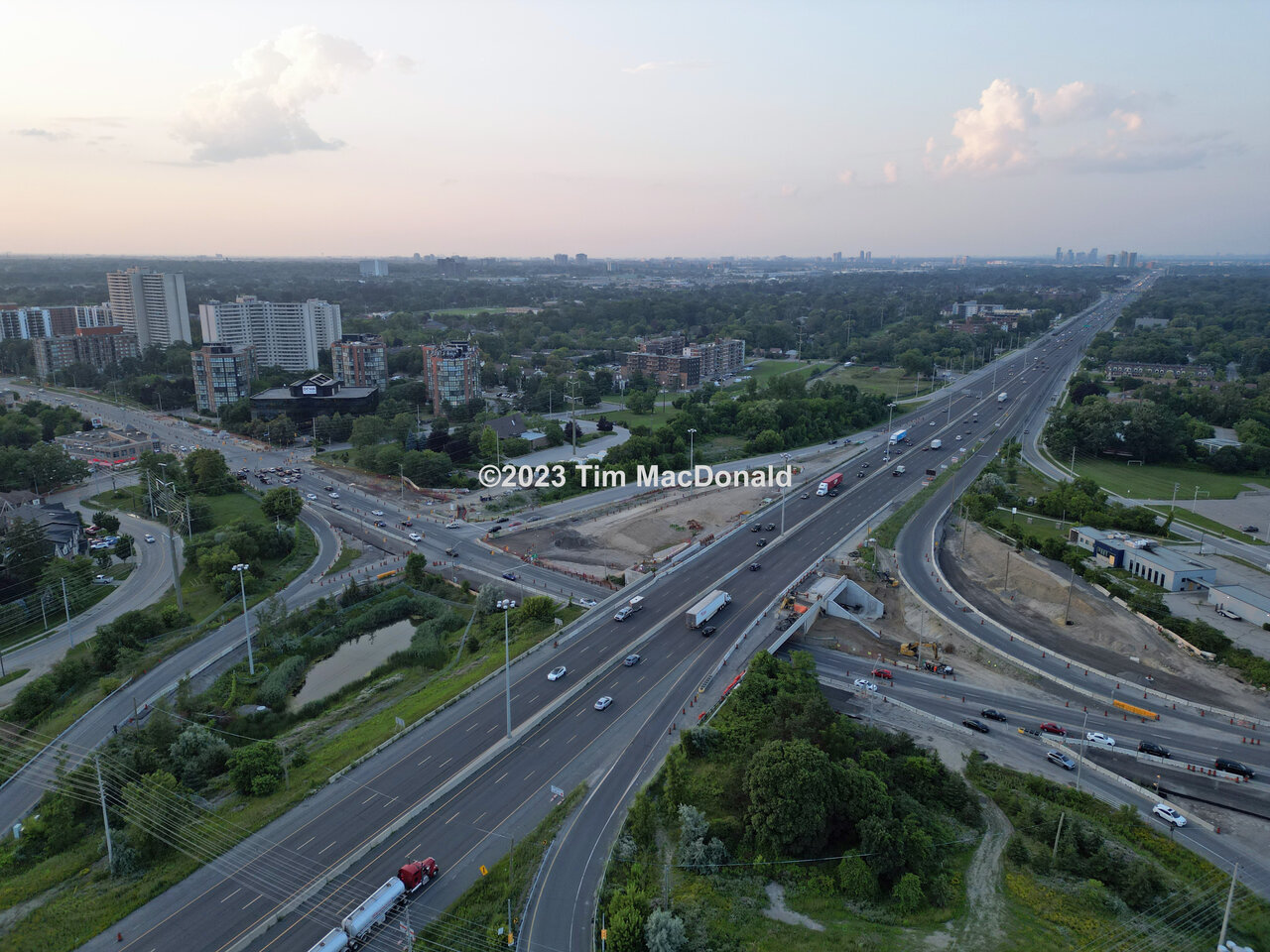

The new Englewood Bridge is paved as well both sides of it, but missing the railing. One hope they are not planning on open this bridge anytime soon as no traffic lights foundation in place as well having the guideway in place to take the tracks from the centre to the side.

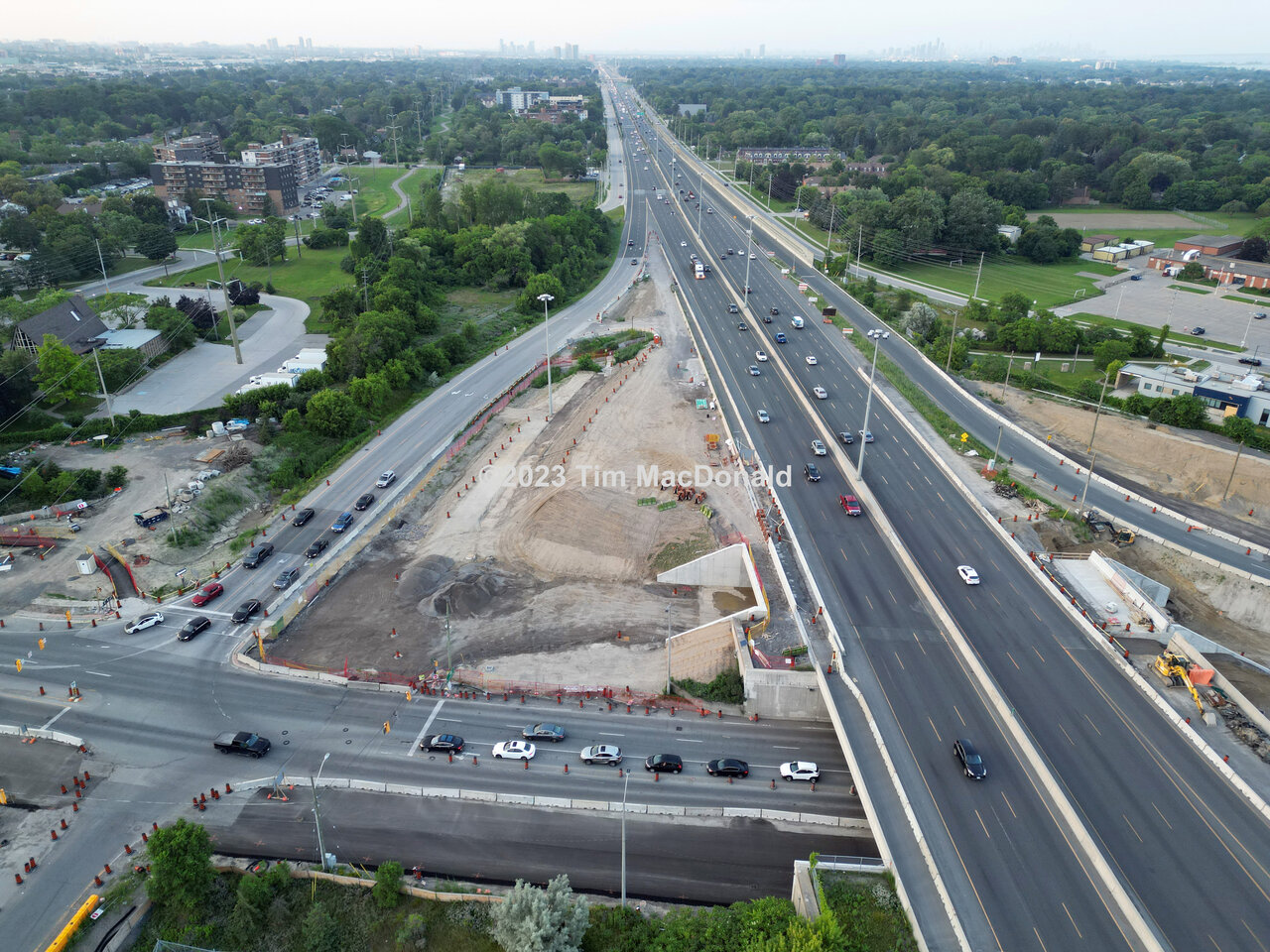

They have shifted the lanes to do waterline work on the east side.

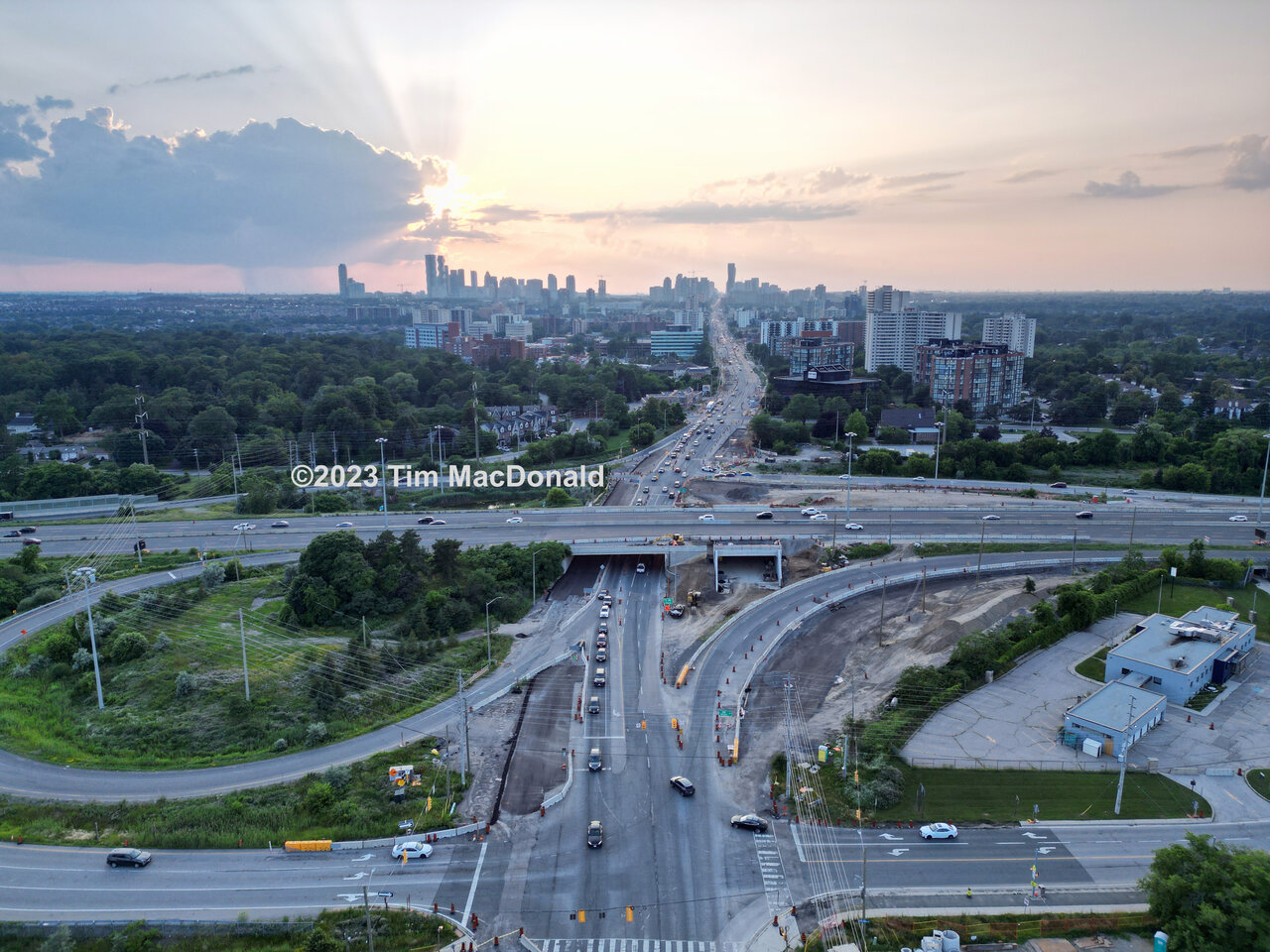

Bristol Intersection close to e-w traffic and Route 10 buses. The intersection close until Aug.
New small sidewalk light post installed south of Sq One Dr for the southbound lanes.

They have removed a strip of asphalt on the Rathburn bridge next to the sidewalk and no idea why. Was told a long time ago that the bridge wasn't to be touch for this project. The only thing I see that could happen is the sidewalk is now to be replace as it needs some work.
