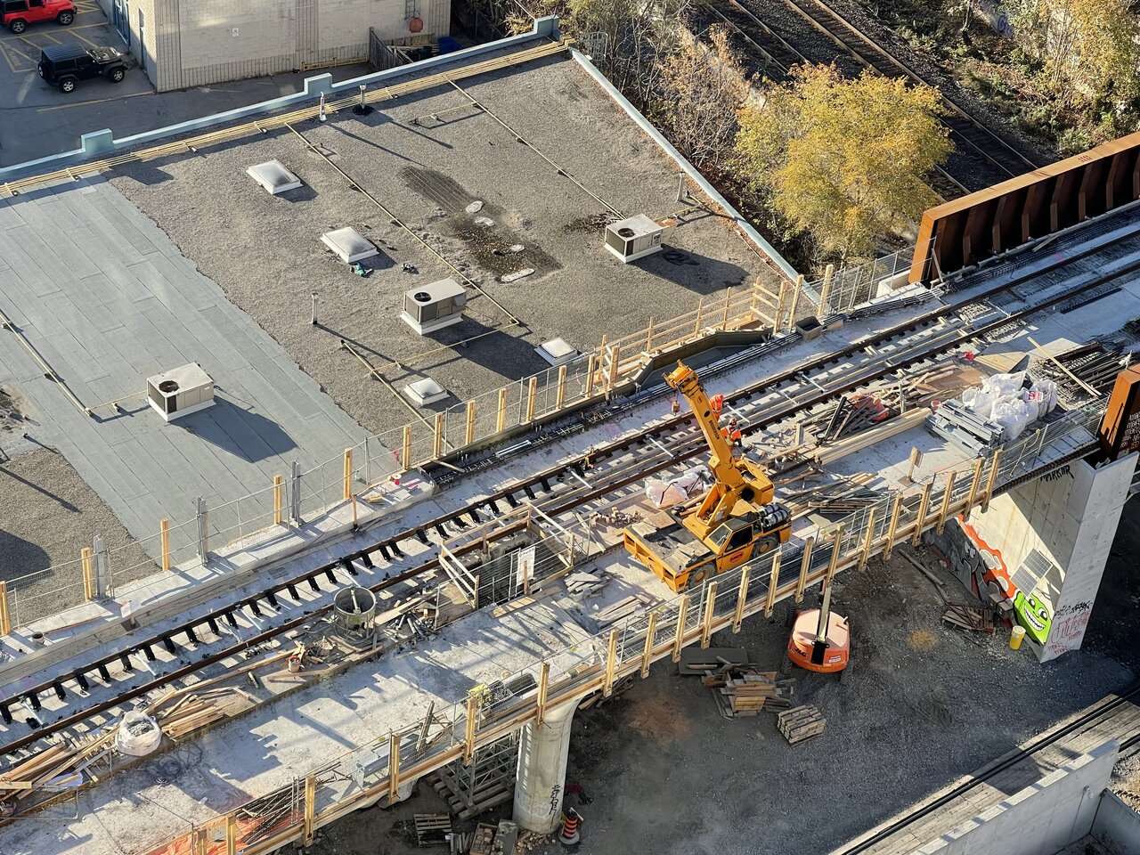

Are those tracks getting laid that I see
Where is the ballast?Are those tracks getting laid that I seeView attachment 435874
How does that dampen the vibration of the train?According to the EA document track on the guideway will consist of rail fastened to concrete plinths. No ballast required, except on the end ramps.
I guess they have rubber padding or something that prevents the vibration from being transferred to the concrete similar to Street car track.Read Appendix E of the EA.
The guideway was assessed as producing less vibration than ballasted track on earth.
it will definitely simplify maintenance long term. No ballast to dig out and everything is hard fastened to the structure.According to the EA document track on the guideway will consist of rail fastened to concrete plinths. No ballast required, except on the end ramps.
