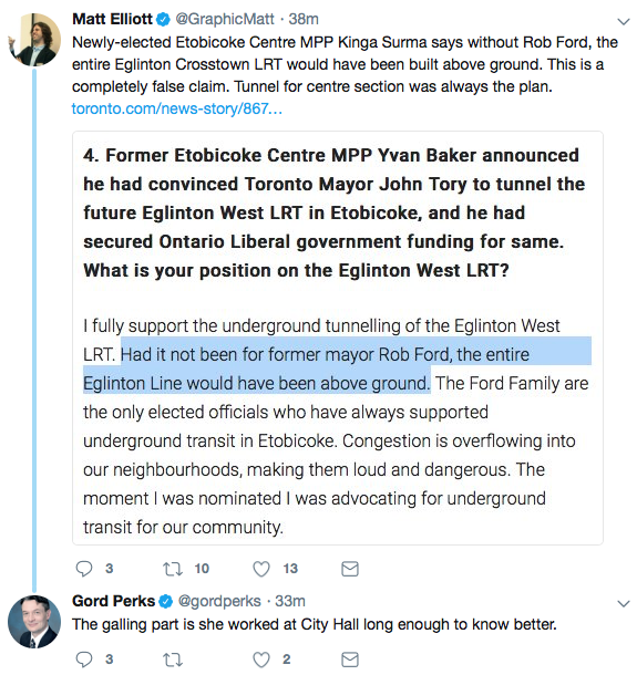

The new government hasn't been sworn in yet, but the lying and aggressive misrepresentation of facts has already begin. This is what we can look forward to over the next 4 years.
