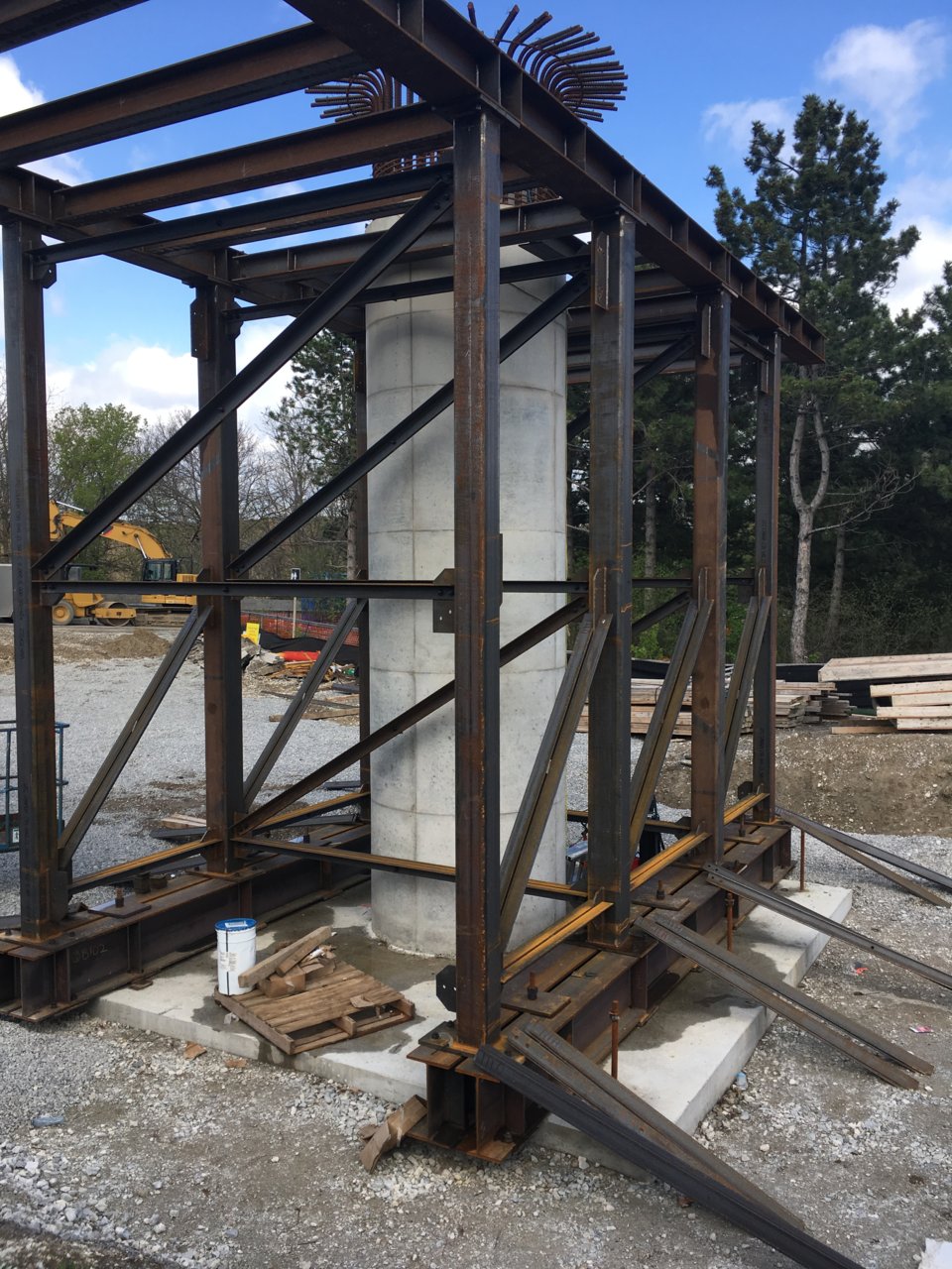

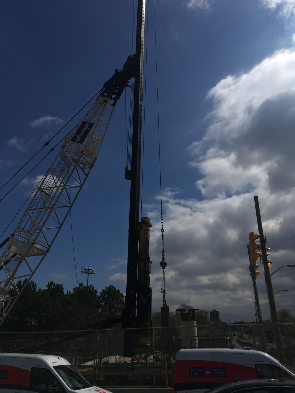

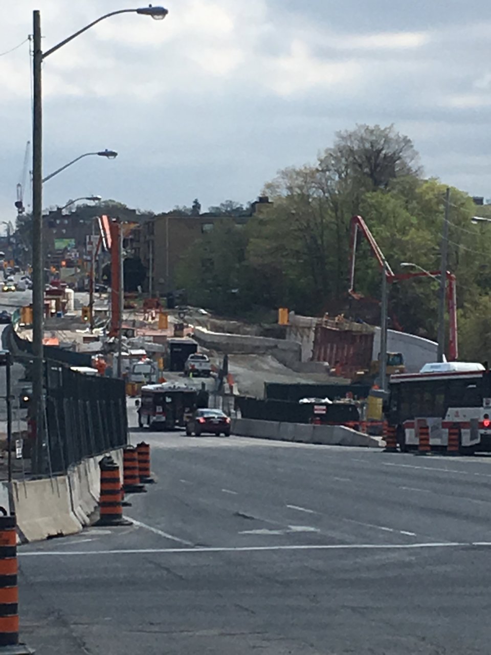

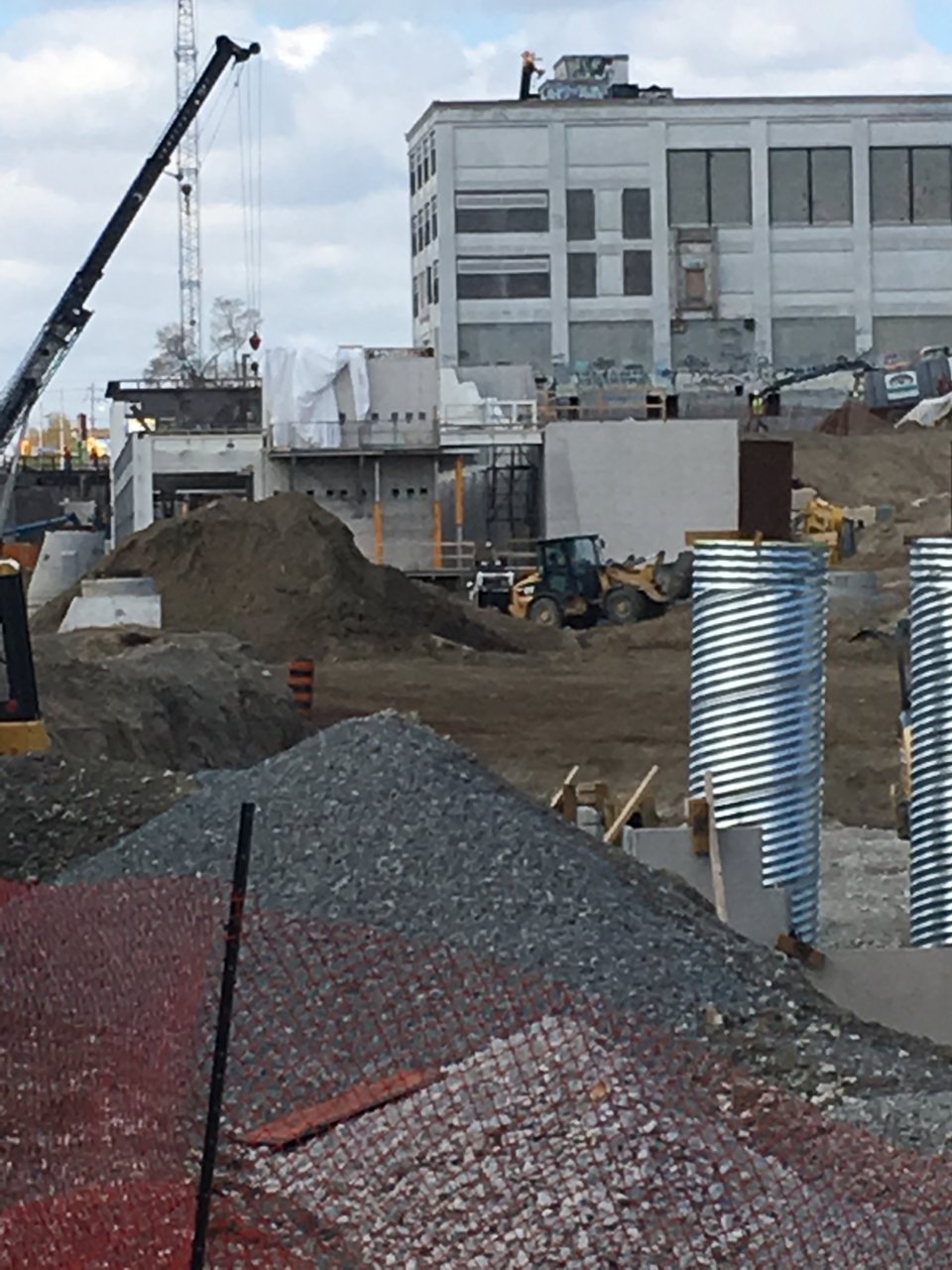

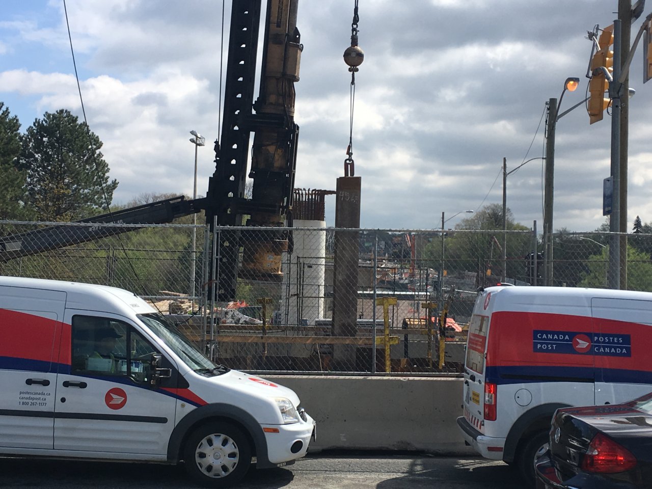

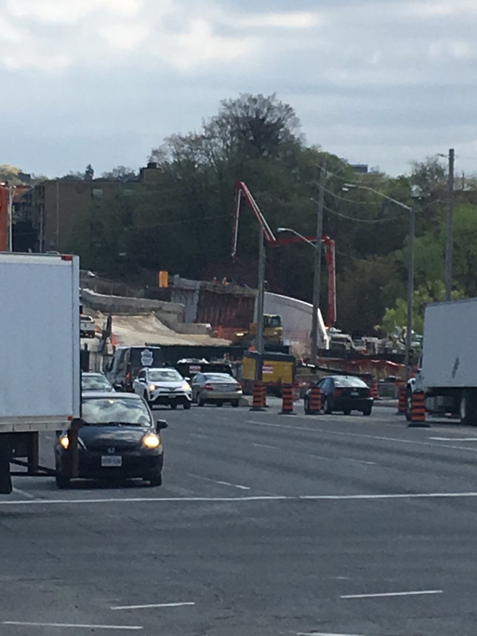

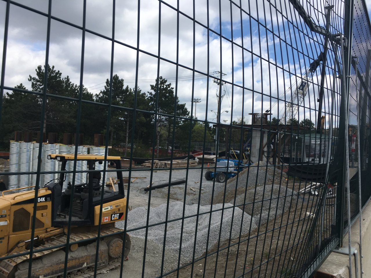

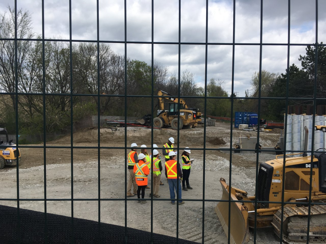

Was in the Area Today just a few pics:
Metrolinx pow wow
