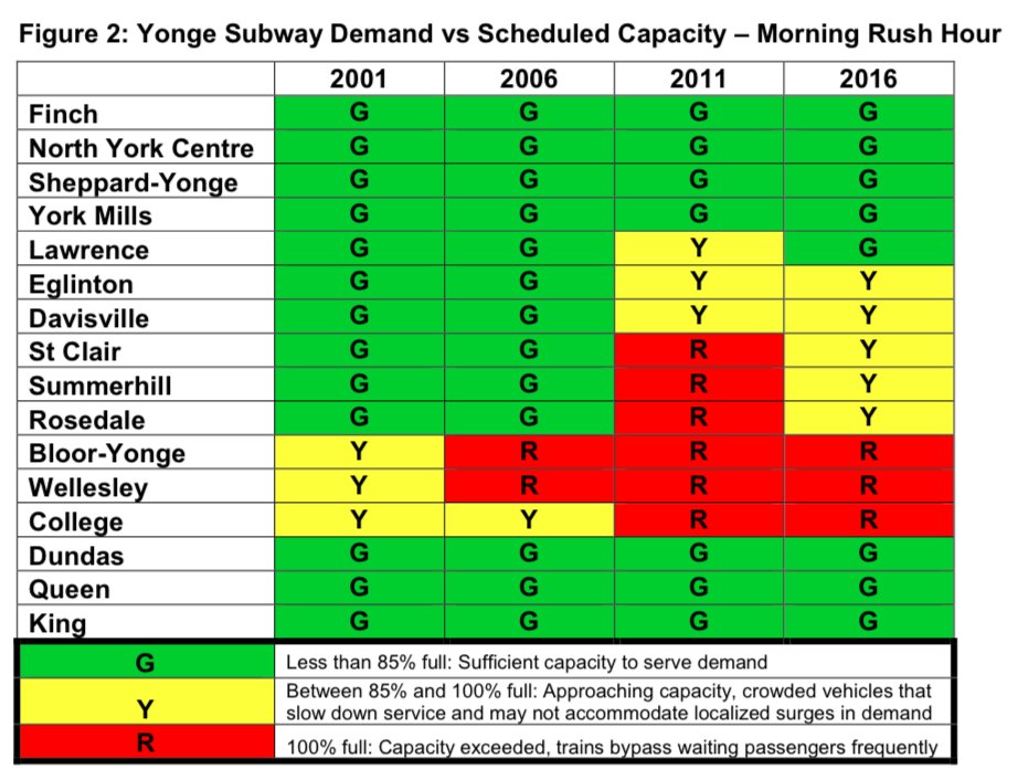

Isnt this the same organization that came up with this chart below, but yet they seem intent on making the problem even worse at Eglinton:
Congrats to the TTC for making yet another boneheaded, and to put it bluntly, stupid decision. Why they came up with this half-baked "compromise" is beyond me.
