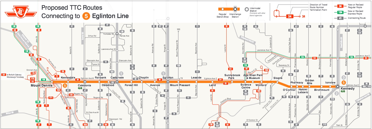

Wow. Eglinton will only have 5 routes, with 2 of them being duplicate services of the Yonge and Eglinton lines. The days or Eglinton bus madness are over.
4. The 97 Yonge doesn't enter the bus terminal. Technically the 34 Eglinton doesn't have to either.
The 54 bus terminating at Don Mills station is a surprise. I would have thought it would go to Laird where the trains short-turn.
It also means that the people between Leslie and Don Mills on Lawrence who today are used to 5 minute service, will be getting none at all.
Not surprise. It's been planned like that and appeared on the SmartTrack proposed route changes. Science Centre Station is getting a major bus terminal and no bus terminal is getting built at Leslie/Eglinton.
We are talking about 30 minute frequencies. If I was a local resident I would not be happy with this change. :p
At least doubling the number of buses to 4 would do wonders for frequency.
The 162 probably won't see any better service. Maybe a new 51 Leslie branch heading east to Don Mills/Lawrence. The 56 Leaside bus is busier than the 51 so there will be branches of the 51. The 54 doesn't pick up a lot of riders on Leslie and very limited before Don Mills.

Changes to TTC Bus Routes in Eglinton Corridor for Line 5 Rapid Transit Line
This report is available at this link.
Proposed routes. Meaning, subject to change.
Also, with extensions to Line 5, the routes to both west and east terminating stations would change. Also, any new rapid transit routes would also make changes whenever they show up.
I would have liked if the TTC merged the two halves of the Avenue Rd and Mt Pleasant routes, instead of having two separate bus routes for the same street.
The original EA said that the 5 (future 13) and 61 would be merged but I guess that won't happen after all. The 61 does have a higher demand than the 5.
Let's not forget that this is just a preliminary report re: bus routes. It says itself that it will be finalized starting in 2019. I too think they should merge the Avenue Road and Mount Pleasant routes but I guess they don't want to make the good burgers of North Toronto have to transfer twice to get to the Yonge subway (and ride only one stop on Eglinton line 5).
I wonder if the Eglinton 34 and Yonge 97 (not shown on map below) will go through the bus terminal at Eglinton station and similarly will the Don Mills 25 (not shown on map below) go through the terminal at Science Centre station or just stop on the street outside the pedestrian entrances like the 34 and 51 will at Laird station.
As far as the 162 I imagine it will be tweaked to drop down Don Mills Road from Barber Greene and loop through Science Centre station bus terminal. Also they should tweak the South Leaside 88B and have it come north on Laird from McRae and go east on Eglinton, then south on Brentcliffe to Vanderhoof (reverse in inbound 88A direction) so that it can stop on street both ways at Laird station at the same stops as the Leslie (via Leaside) 51.
