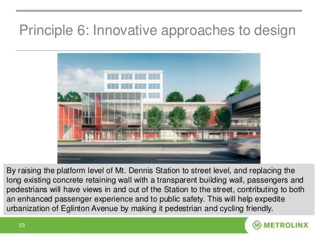

So if the platform will be at street level, I assume it will be far enough from Weston Rd that the trains can dive under that street and then resurface again toward Jane?

The tracks will go down an 2% incline from the Black Creek overpass (over Black Creek Drive) and into the hill at Weston Road. The station box may have a 1% incline. The current design will be have the station box partly exposed and partly in the hill.
This is the 2013 design, so it will be have to be updated.
