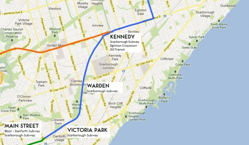

Regarding the "replacing the SRT with a subway extension" scenario, I'm never certain what the favoured (or "popular") alignment is among Scarborough residents. Is it straight up McCowan Road (including those portions that Google Maps doesn't recognize as a roadway) to Scarborough Town Centre? Or is it up Danforth Road to the point where it converges with McCowan Road, and then northward?
Most Scarberians, and Rob Ford himself, seem to be under the impression that the existing SRT alignment can be converted to subway. Most people don't seem to know that the geometry simply doesn't work.
To me, the alignment that makes the most sense is Eglinton-Danforth-McCowan, because it allows for a gentle curve northwards. I also think it's worthwhile to extend the subway to Sheppard & McCowan, and not terminate it at STC.
Also, I have wondered on occasion if, rather than extending the Bloor-Danforth Subway Line, we could treat Victoria Park, Warden, and Kennedy subway stations as the first three existing stations of a Scarborough Subway Line, and build a new Main Street Station platform underneath the existing one to create a transfer station. In this way, Main Street would become a terminal station for two subway lines. The Eglinton Crosstown would interchange with the Scarborough Subway at Kennedy as it travelled northward to Scarborough Town Centre and Sheppard (and eventually, beyond). I have attached a graphic below.
I can't really see the utility of that. You'd be abolishing an existing thru-line in order to impose a linear transfer. For a lot of people, you'd be adding in an extra transfer for no reason.
Either extend Bloor-Danforth up to Sheppard, or interline the Eglinton and Scarborough LRTs. The goal should be to create fewer transfers, not more.
