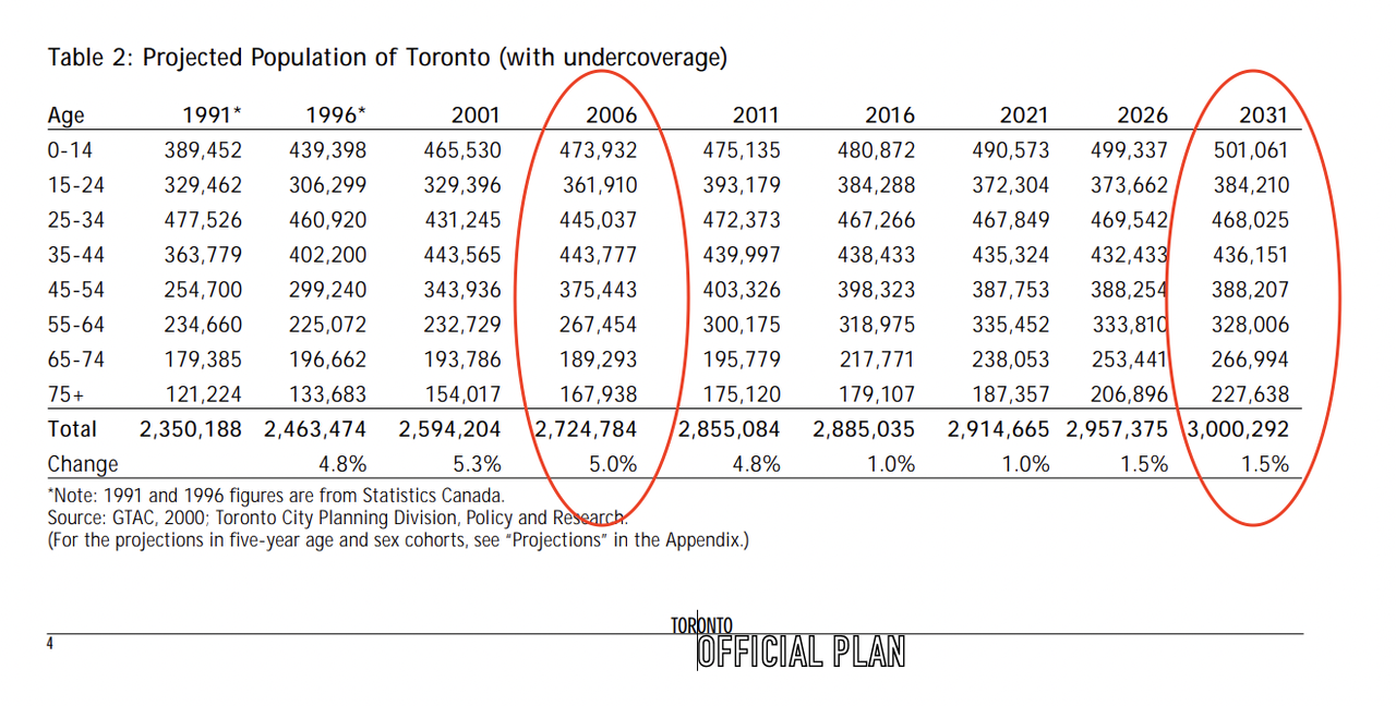

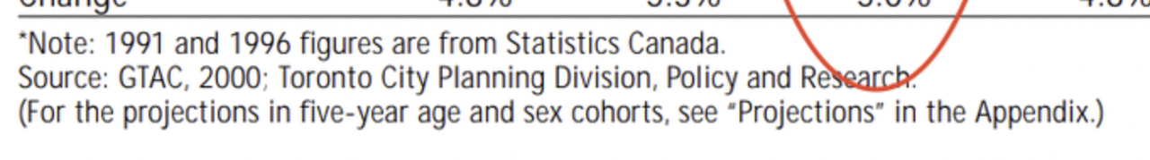

The City of Toronto's official plan numbers they are citing for this forecast dates back to 2002 at least [2000, actually], before the official 2001 census numbers were released, as part of Flashforward: Projecting Population And Employment To 2031 In A Mature Urban Area - Looking Ahead Part 1. edit, added source: https://www.toronto.ca/wp-content/uploads/2017/08/9529-Flashforward-Looking-Ahead-Part-1.pdf
The city of Toronto has seen much more than a 270,000 increase in just the last 5 years, let alone since 2006.

In a nutshell, the projections for population and therefore demand for Line 5 was based on numbers from 2000.
We know Toronto had much higher population growth than projected. We're at 3.3+ million when they predicted 3 million by 2031. So roughly 10 to 20% higher population in the catchment area.
