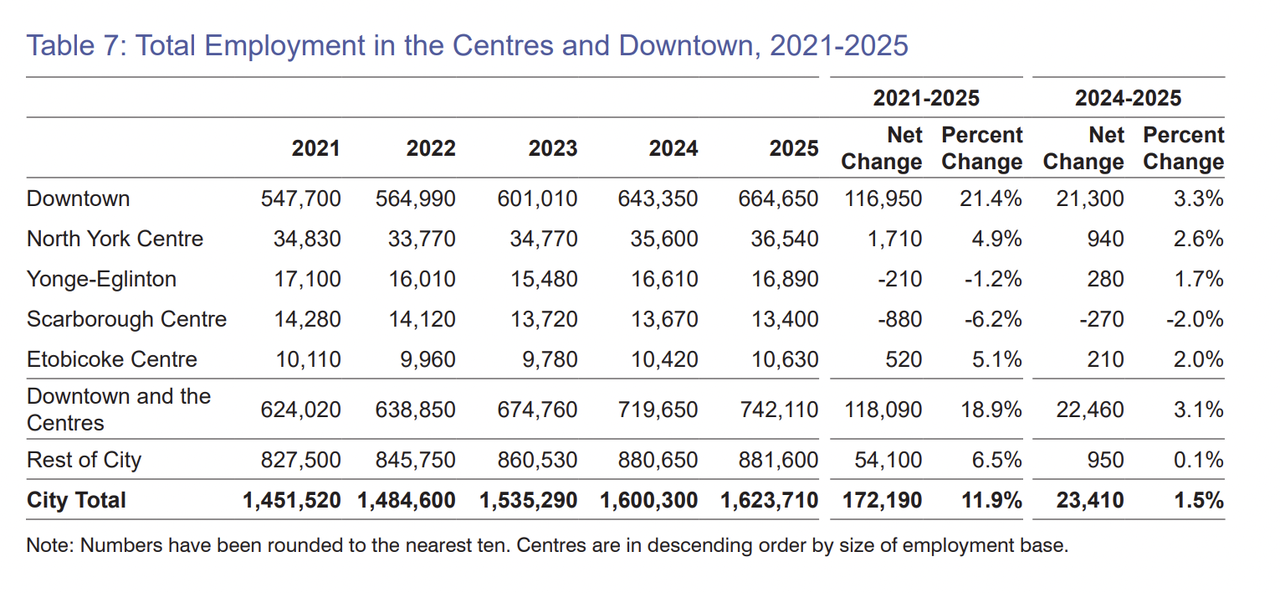

Downtown has way more jobs. In the future, I don't see Eglinton east getting close to even Scarborough Centre job numbers. Even if there is housing densification. Setting aside visiting neighbours and shopping, Brentcliffe and Golden Mile won't be destinations the way all of Downtown is. That means rail transit serves to bring people elsewhere.
So the benefits of tighter stop spacing are low. And @nfitz is right, getting rid of Hakimi, Ionview, and Aga Khan would solve the problem. Without those 3, stop spacing would be ~935 metres, even wider than the tunnelled western side (~850 metres).

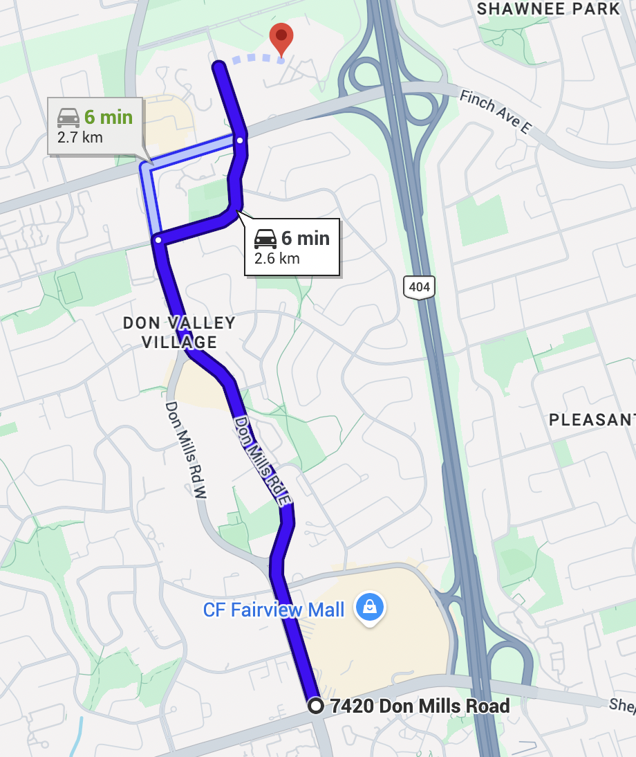

Almost had this discussion about an Ontario Line North extension. Even if you stuff the Don Mills Rd West/East peanut full of high-rises, it would still be surrounded by a sea of low density housing and few jobs. Stop spacing in the relative suburbs should be wide. Just because you line Eglinton Ave with high density does not automatically make the wider area dense enough to support <=600 metre spacing, as if it's downtown. 4 stops from Seneca to Fairview Mall would be ridiculous.

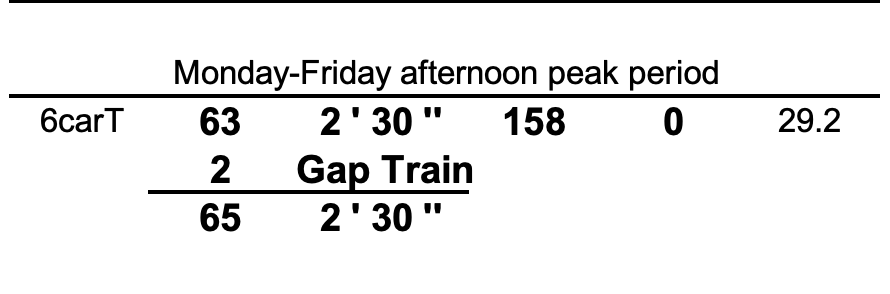

Line 1 runs more frequently. ATC theoretically allows 1'55", but it currently runs slightly better than 2'30" with gap trains.
